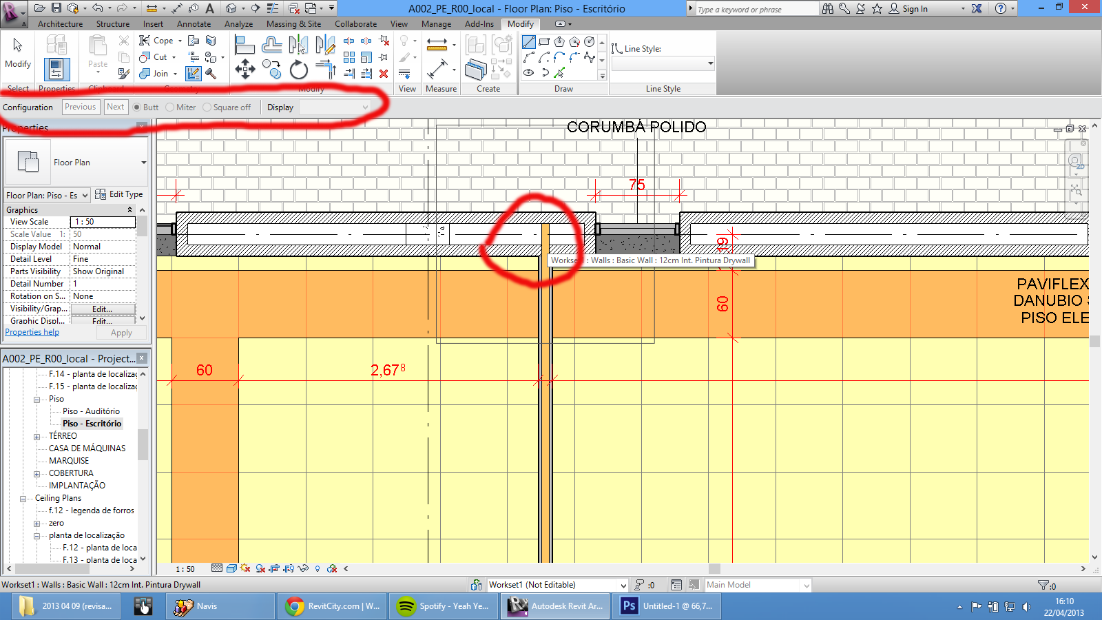

I'm using 2011 and I'm having issues with my wall joins.  I have worked on a floor plan over the past few months and have altered wall joins to show the new construction abutting the existing construction in the plan view.  After having developed the model a bit more and adding new views (at different scales), design options, etc., when I try to manipulate the wall joins in any newer view, my 'join options' are now grayed out and uneditable.  The earlier views still allow me to edit the wall joins, so I'm not quite sure what setting would limit my ability on the newer ones.
I realize I could 'disallow join' but that would be tedious and I would prefer the wall join tool to work.  Also, is there a way to change new-to-existing wall join conditions universally (and set them to 'not clean joint') or is that asking too much from the software?  Thanks in advance!

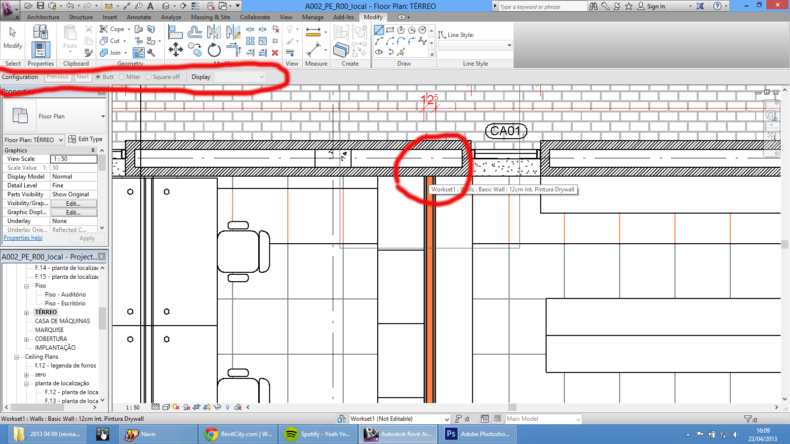

WW,
I'm not calling you a liar, but I'm not sure why this is the case here.  Please see the attached images.  The two plan views are at different scales and have differing wall join conditions.  In fact, I just clicked on a third plan view that shows the wall joins correctly (with the color scheme) but incorrect scale.
Also, I AM able to alter the joins of some portions of the plan, but not others.  I have tried checking out all the worksets, setting the work plane to the respective levels, etc., but still no dice.

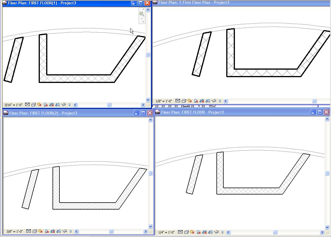

I just did a test project with a curved wall - existing phase, then added perpindicular and angled intersecting walls - new phase, and then created several new plan views at various scales.  In all instances, my walls cleaned up correctly with no modification required.
My conclussion is that you are doing something you have not told us.
Are you using design options?
Is the curved wall a wall by face form a mass?

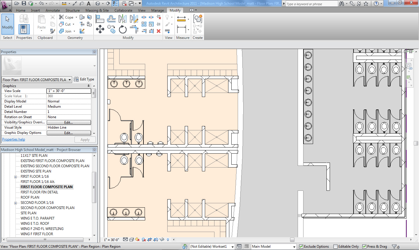

Below is my test project with 4 different scale plan views.  As you can see, they all clean up correctly.  BTW - I am using the default cleanup and I changed nothing.  No editing required.
Are you sure you don't have multiple walls in the same place?  I notice in the room to the right, I see what appears to be two different walls below the toilets.  One wall slightly above the other.  Multiple walls in the same place could cause the issues you are seeing.  Delete one of the walls that doesn't clean up and see if there is still a wall there that does clean up.

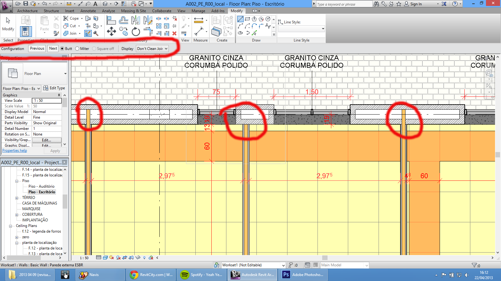

Hi Badkube,
WW is trying to help me on this one as well on another thread. Here is what i posted there:
"first image: the join i edited before in red (don't clean join), that is how i want it to be. the problem is, i can no longer edit it, as indicated in the upper left corner with the grayed out configuration options.
second image: same join in red, other view, different join configuration. this view i made after making the central file, and when i try to edit the join so it does not clean join the options are grayed out, as indicated in red.
third image: the join that i am still able to edit (middle one), along with some i cant (right and left). you can notice the configurations are not grayed out and open to be edited."
