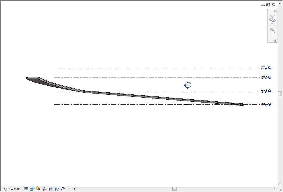

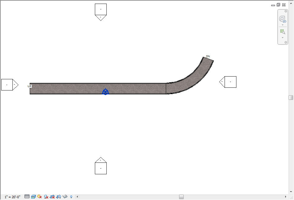

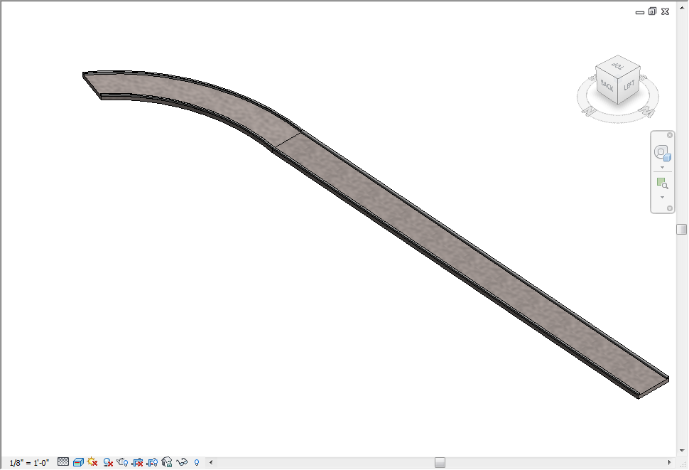

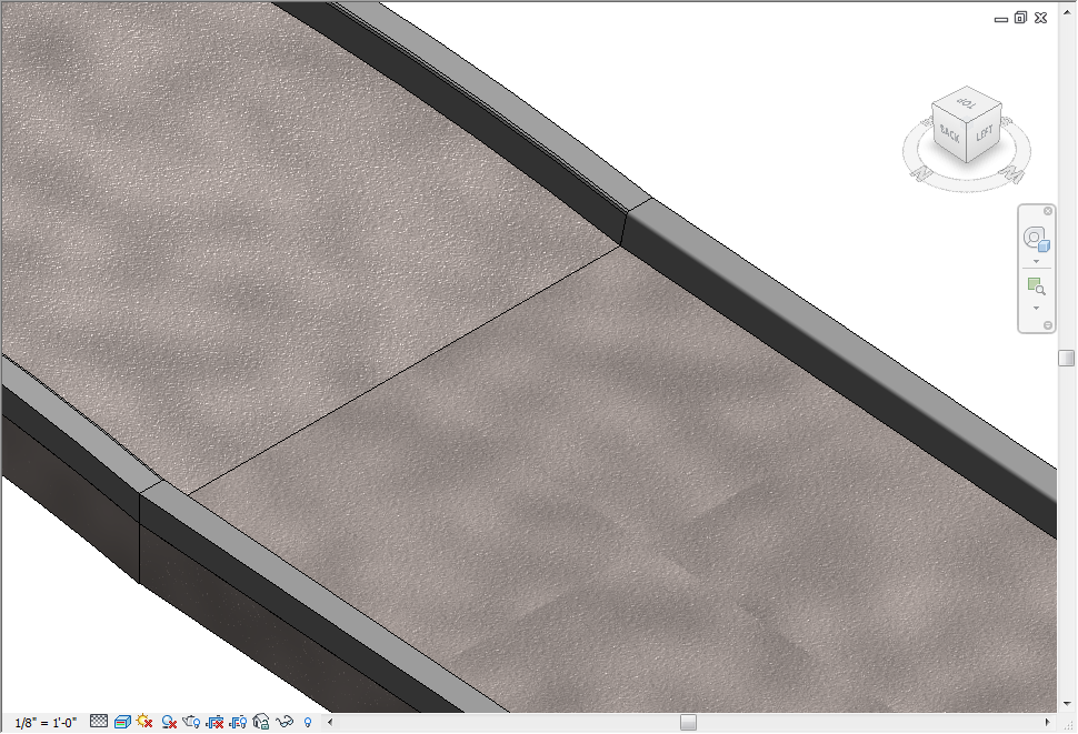

I would like to model ramps in revit. I have some that are just square. and I have some ramps that have curved tops and bottoms.  All i can create so far is a playpen with the railings.

The attached were created using ramp, with a curb profile added as railing.
