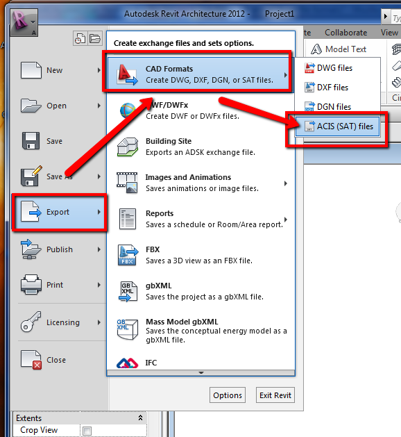

Export to ACIS (SAT)

Even easier - did you look at the image Typhoon posted?
Edited on: Thu, Dec 15, 2011 at 1:43:05 PM
Thu, Dec 15, 2011 at 1:42:54 PM | Can Revit save a file for use in SolidEdge OR any of these file formats?
Joined: Tue, May 22, 2007
5921 Posts
4 Stars: 205 Votes
Watch my image....

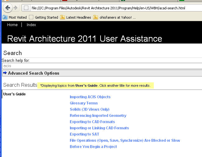

Im sorry, The image file wasnt uploaded yet when I replied.  and YES, I did go thru the help and couldnt find it.  I know you claim it is great, the help section, but I find it difficult and usually of no help.  I dont know if MEP help is any different than Arch help.  Anyway, I will look at the image, thanks!

Thank you and that helped.
Since I dont know what a .sat file actually is, I am not sure that when I make it, does it give me only the exact view that I see, like if it was exported as an autocad file, or does it make it a 3D file of the image?  If it is a flat image with no 3d, I may need to make mutiple .sat files to show exactly whats going on.  Can someone tell me which way it is?  Thanks!

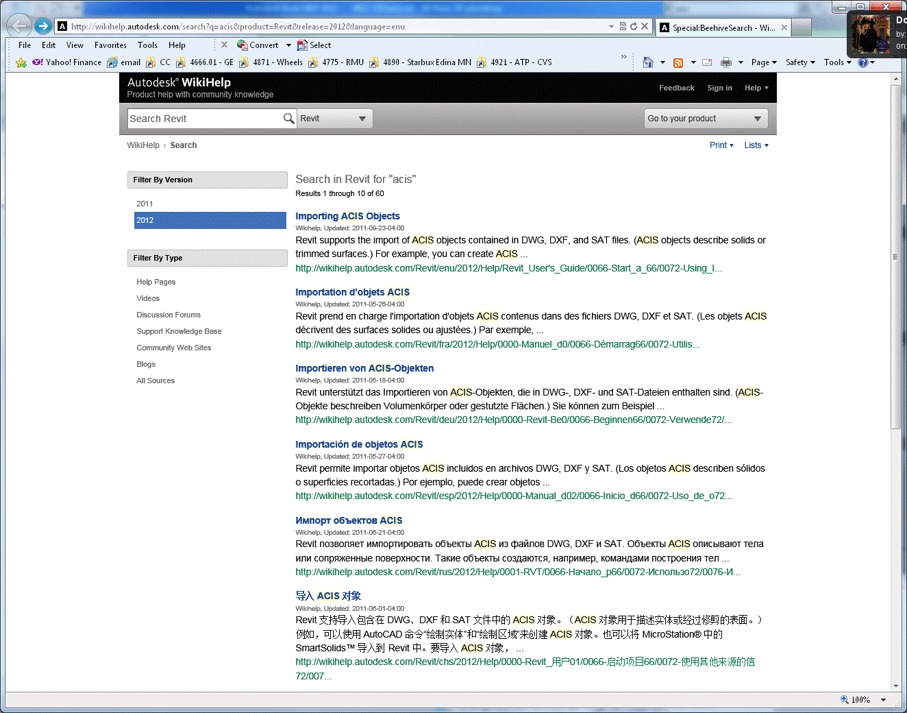

I really do appreciate all your help.  What I use for help is the search feature at the top of the Revit screen in MEP 2012, where it says "type a keyword or phrase".  I type ACIS, and you can see the by the image what it found.  The first one says importing.  Nothing at all in the top 10 says anything about exporting, and a few in the top 10 are in other languages.  This is why I say it is difficult.

I see.... We don't use wiki-help because our mcafee filter has to check everything and it just takes too long. Now I have another reson not to use them.
Revit is provided with HELP files that you have installed and you can set your pointer to just use those.  I believe you will find this much better and faster.
