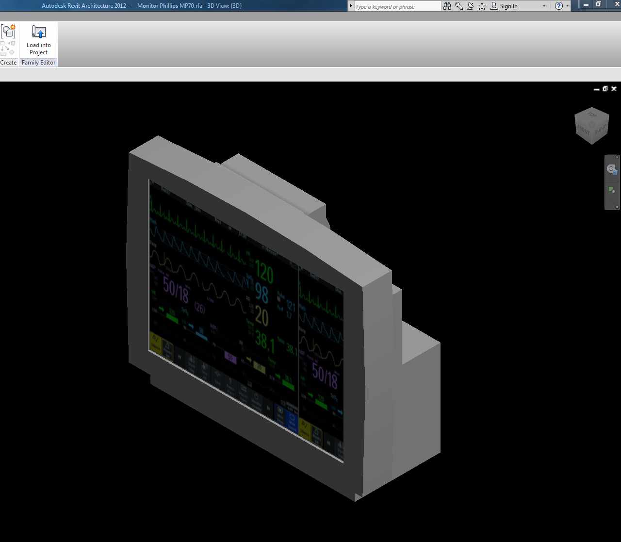

Here is an Example of the decal I used for this Phillips MP70 Clinical Monitor (inside a Family .rfa) you have to be carful
choosing tilling and scale when doing this with materials inside familys a bit of trial and error, there are good editing
options for materials to get placment on the object right.
