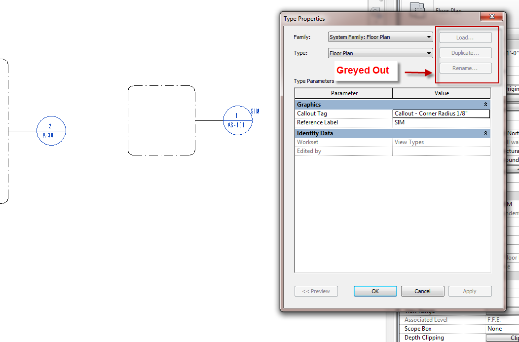

just create a callout referencing another view, then select it and in the type properties duplicate the System Family: Drafting View
you can has as many different types as you want

Yes, I would agree but mine is greyed out

Ok, I think I am understanding
you said drafting view I am looking at enlarged plan views...  They work different?
You wouldn't have a typ or Opp or Sim enlarged view, would you?

when you are creating the callout change the type selector from Floor plan: Floor plan to Detail View Detail. You can duplicate the System Family: Detail View. I have one for each type of detail sheet I use for browser organization. like Door Detail, Window Detail and so on.

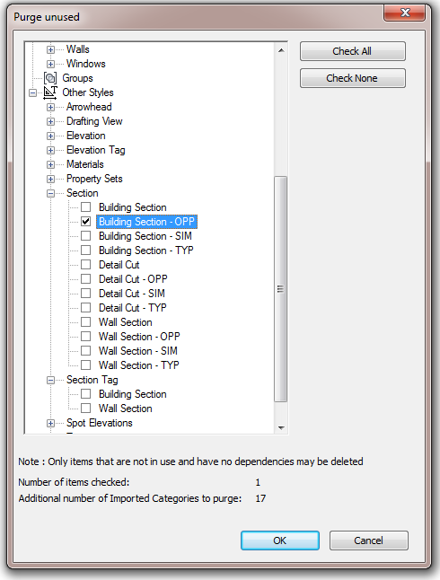

Ok, I am still jacking around with these tags
I have figured out the Elevation Tags and SectionCut Tags do not work the same.  Elevation Tags work as I would expect them to and this is what I think I was working with some time ago because it works as I would think it should.
It is the Section Tags that seem to be the pain in my side.
How do you have a master section cut and have two referencing tags with different reference labels?  I might have a view where I want to say one view is SIM and the other is OPP but it seems I can only choose one.
If I make one reference SIM to my master and then cut a new section and reference it to the same master and apply OPP to it my SIM changes to OPP too...
I have tried many combinations for rebuilding and creating new family types but I can't seem to get it to give me more than one or the other but not both....

Tue, Dec 20, 2011 at 7:50:38 AM | CallOut Heads giving me fitts
#15
cadman6735
cadman6735 Avatar
Joined: Thu, Nov 13, 2008
148 Posts
5 Stars: 4 Votes
This thread helped, just passing it on...
http://forums.augi.com/showthread.php?t=125505
