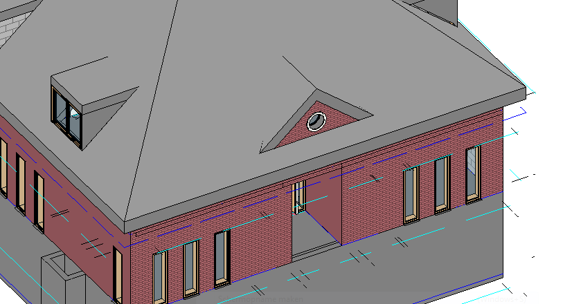

I've made a roof with a triangle dormer. (see files attached) But i can't join the dormer and the main roof, so that the dormersroof adapt to the main roof. Someone knows how to fix this problem?

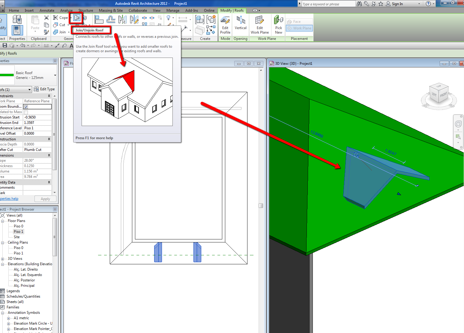

Use "Join/Unjoin Roof" tool.
