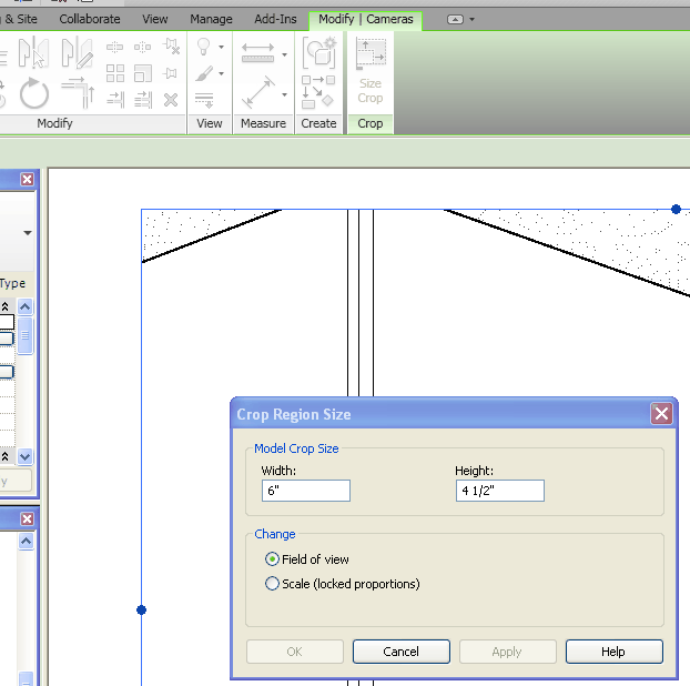

If I use a  camera view in revit it always shows me what I want, but sometimes the image is only four or five inches. Is there a way to change the image size
Mon, Dec 12, 2011 at 8:40:26 AM | Change image render size of perspective photo
Look at the crop size settings for camera views.

See attached Video

thank you for the good advice, I didnt think that should be too hard
