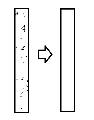

Hello, how to hide wall structure in the plan?

change the detail level at the bottom of the screen or change what you want to show in the detail level for the particular item involved

Where I can change detail level on revit' 11?

on the bottom strip, next to scale, you can adjust the detail level of the view, you can also modify the detail level in your V/G for each item. Read your help.
