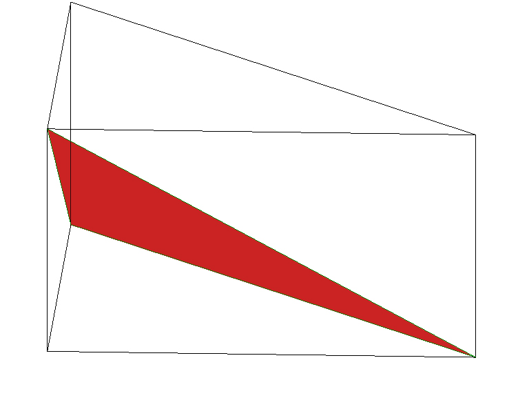

I would like to create the red plane, any ideas?
I made the triangular extrusion and now i need to work on that plane made by 2 base point and one top face point.
thank you!

if you make this as a floor you can set the height of the different corners with 'modify sub elements'

hi, this should be a curtain wall panel, I am working in the family editor, so no floors!
I did the model in rhino and now I am using the imported gemetry planes to build the panel, but I think it can be faster to model directly in revit setting the proper plane with 3point, isn't it?

if you can put a reference plane in the correct orientation, you can orient your 3d view to that ref plane, and put an extrusion on it,
