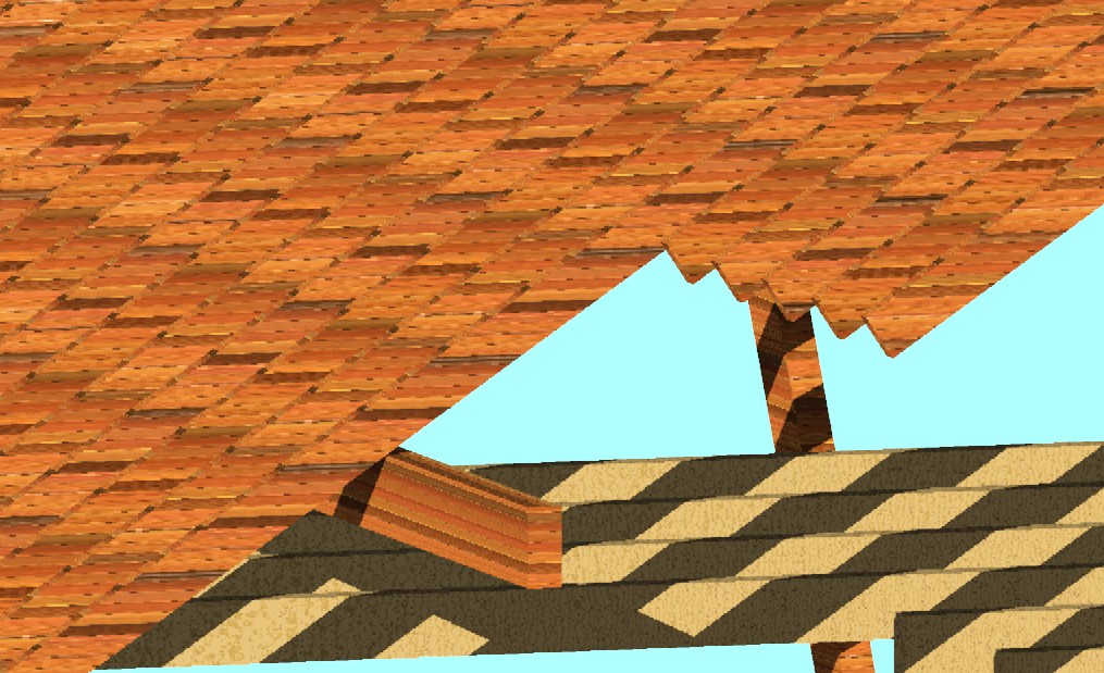

Hello, I am wondering how to add a material to a component (structural gluelam beam) that will rotate when you rotate the component. Here I what happens. Apply material to component which displays fine as long as the component is horizontal but when I rotate it to become a roof rafter the material stays horizontal. Is there anyway to make the material follow the direction of the beam? Thanks John Fleming

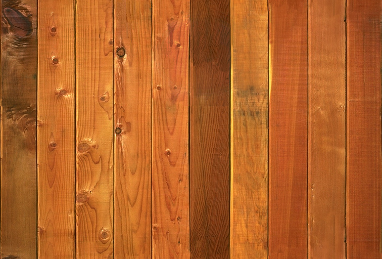

create youre own acurender texture from a photo and rotate the photo image to the required angle before creating the texture.

That is what I ultimitely did but it seems that you should be able to put in a accurender texture and regardless of what it is applied to should rotate with the component. It seems to be pretty complicated if I wanted to have a bunch of componenets at different roof pitches to create a texture for each one.

This is the jpeg I am using for the accurender texture.

Generally materials will align perpendicular to the plane of your extrusion/sweep solid. Not sure why your beams material is doing what they're doing, could be to do with how the beam was created/extruded/swept? Short term fix is, as suggested create a duplicate material with the jpg image rotated in accurender. Long term fix would be to recreate the beams using sweeps and voids. HTH.

Mr. Spot, did the material rotation trick, just didnt know if there was a reason that this is happening. Using the gluelam beams that were packaged with the program. Thanks for your input it is always appreciated. John Fleming
