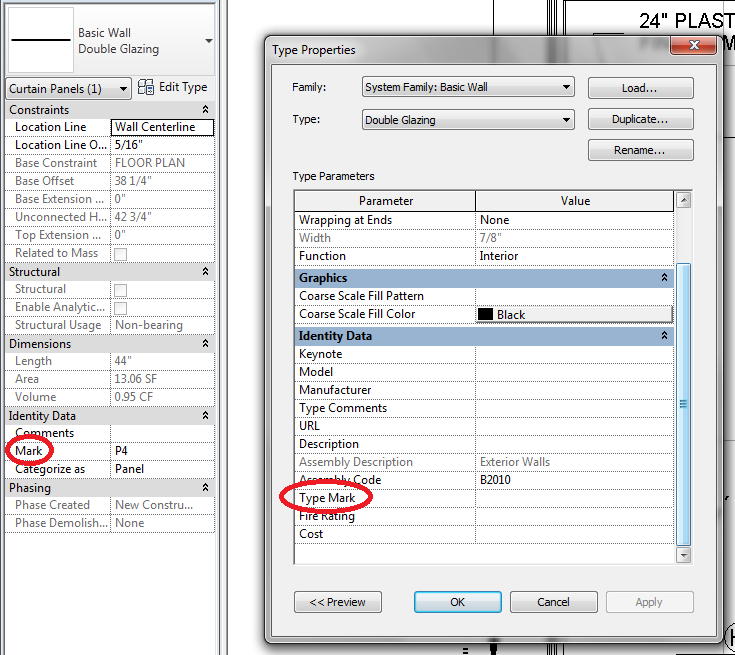

just to expand of what Hub said...
Select your wall and review the list of properties that are available. These are instance parameters all apply only to individual instances of the element. Now hit, edit type and review the list of properties that appear in that dialogue box, these are type parameters and apply to all instances of that type of wall.

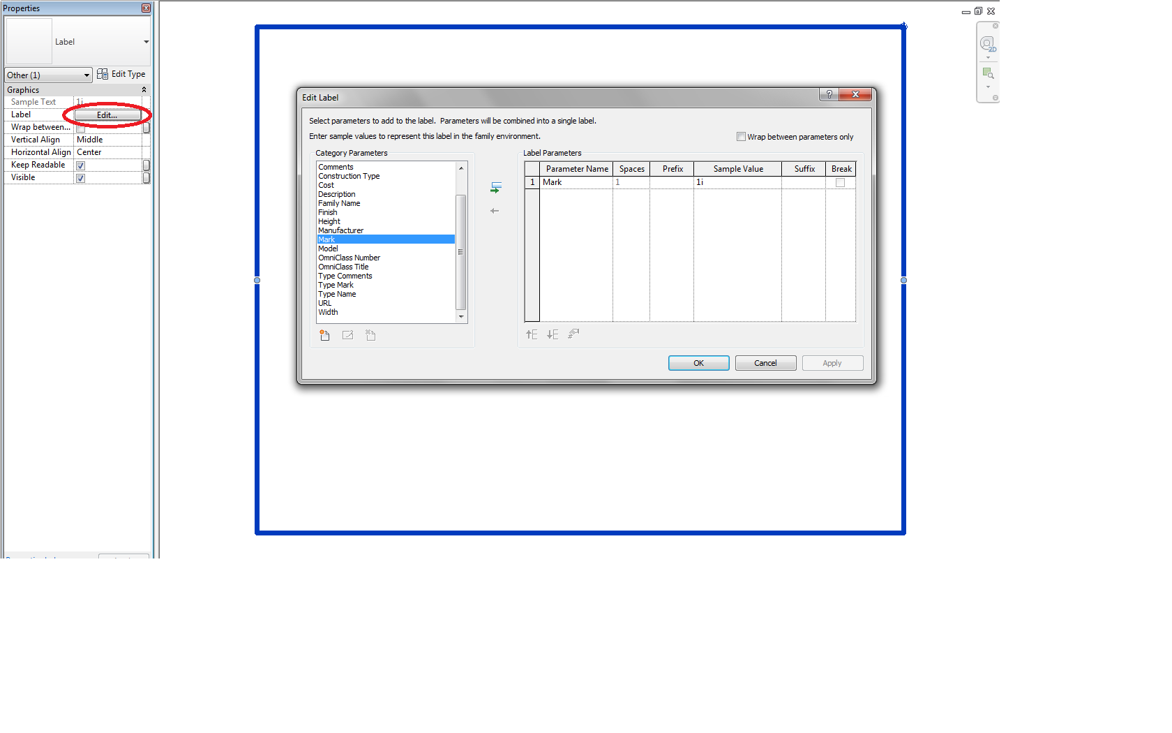

Now select your wall tag, hit 'edit family'. Now click on the tag, then in the properties dialouge, beside 'label' click "edit...." You'll notice a list of parameters come up similar to what you saw in your project. Select the appropriate parameter you are looking for and reload it into your project.
Your getting the "?" because the tag is probably associate with "mark" which is probably empty. I'd recommend switches your tag to read 'type mark' instead and then give this paramater a value (W1) in your wall type properties.
