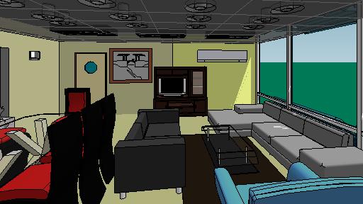

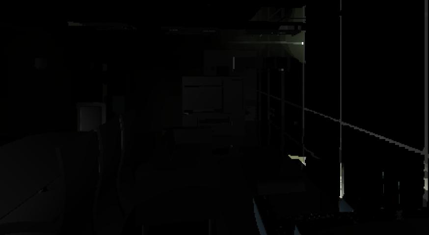

Please i need help on rendering night mode none none of the light will emit while rendering both interior and exterior have done all i could yet nothing seems to work after rendering it only produce this black image which i attached below i really need help please any one there to help thanks

well i just try those adjustment and yet nothing and any interior rendering both night mode and daylight mode nothing seems to work all just come out dark as it is

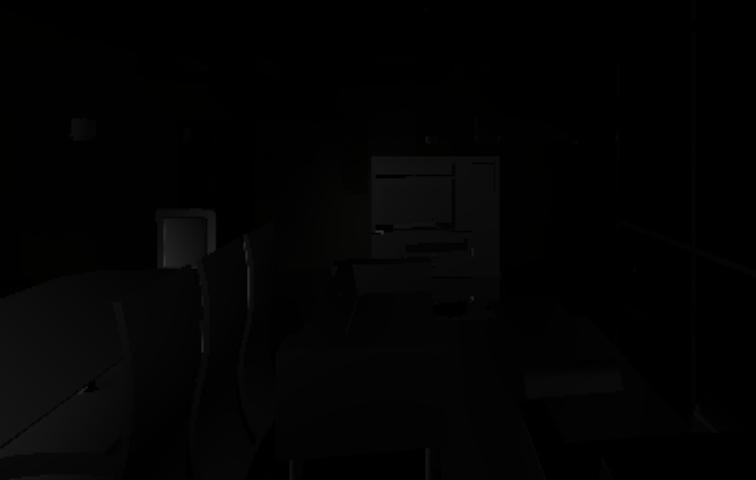

i just reduce my ceilling height from 2.6m to 2.4m and also hide the cielling on the render view so this is what i got

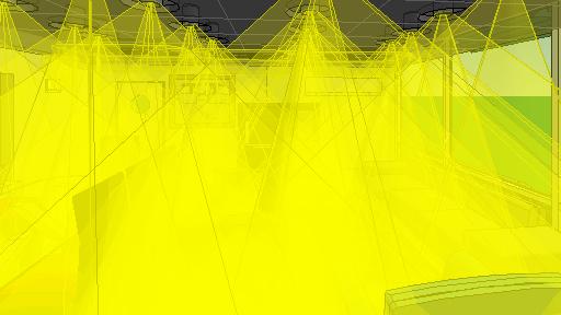

ok what will i do to the floor then.... the picture below show my kind of light, but one thing is when i turn on the light source on from the visibility graphic it show the light source but rendering nothing show

I am 100% positive this is your problem, which is what I am talking about.
http://therevitkid.blogspot.com/2010/01/tutorial-floor-or-ceiling-what-to-do.html
There is even a walkthrough video explaining exactly what the issue is and how to fix it.
(I hope posting this link isnt against the rules)
FYI that is WAY too many lights for that space, do you happen to work for the electric company? (just teasin)

hey hey audio your suggestion work completely for me thank you so much
