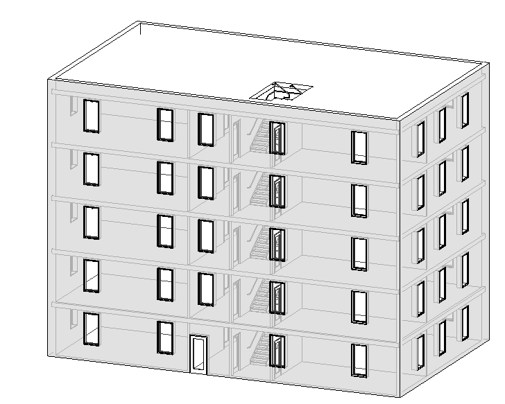

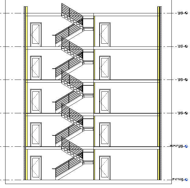

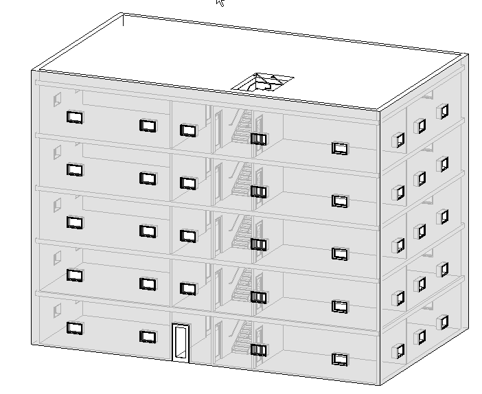

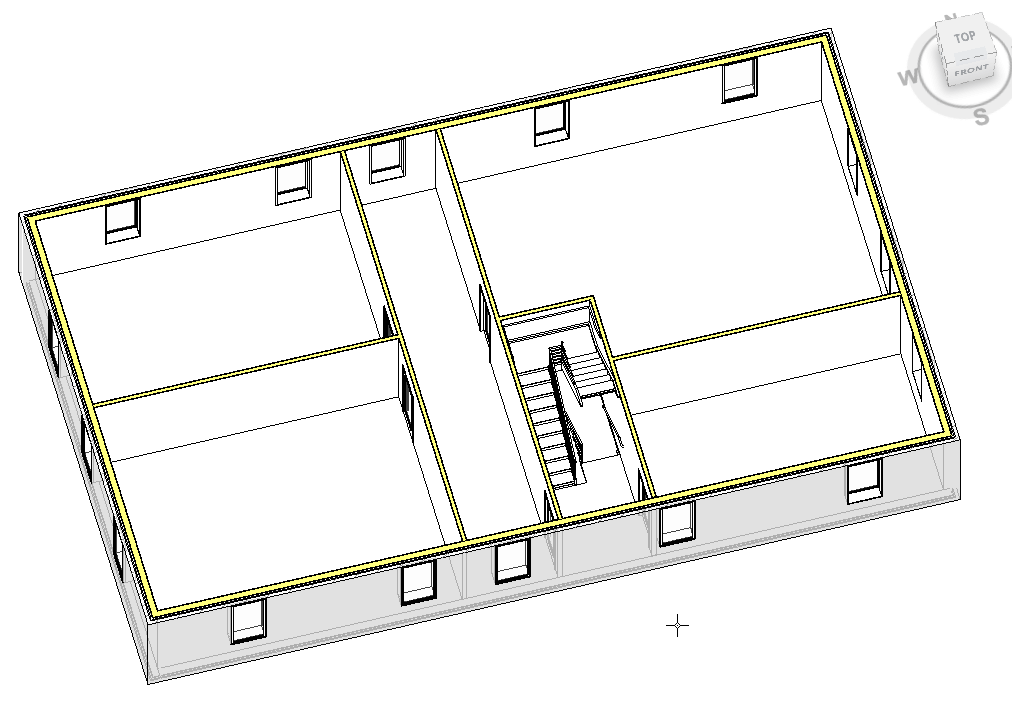

Below is one model - Just a few minutes to build because objects can be copied to multiple levels at the same time.
  1. - transparent exterior walls -
  2. oops - wrong windows - 5 second fix for entire project
  3. hey - these stairs are easy
  4. section box 3D - This can be exported to a CAD file just like this - one 3D file of just this area.  ("...  the architects requested the model be split by level for ease of understanding (they needed a full floor plate visible) and not sector,...")  LIKE THIS ?
Learn to use the powers of Revit.  Your biggest problem will be bringing the limitations you know from CAD and applying those to Revit.
