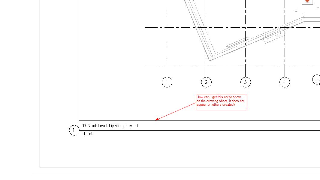

Hi Guys,
I have dragged a view onto the drawing sheet and seem to have a border around this one? the others seem to be there when I hover over them but this one seems to have one when its not selected? Is this something in the VG settings for this particular sheet?
Thanks

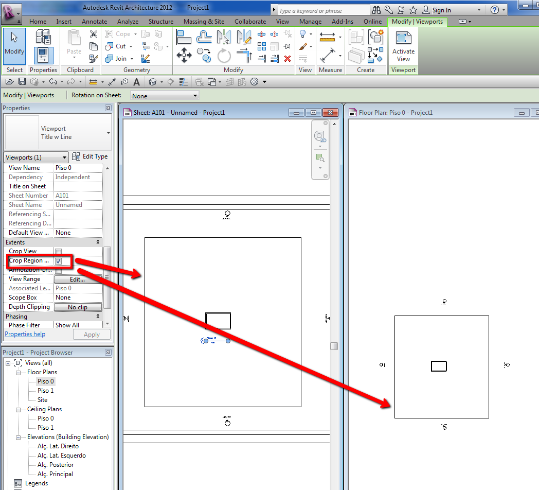

Turn off the "Crop Region"
