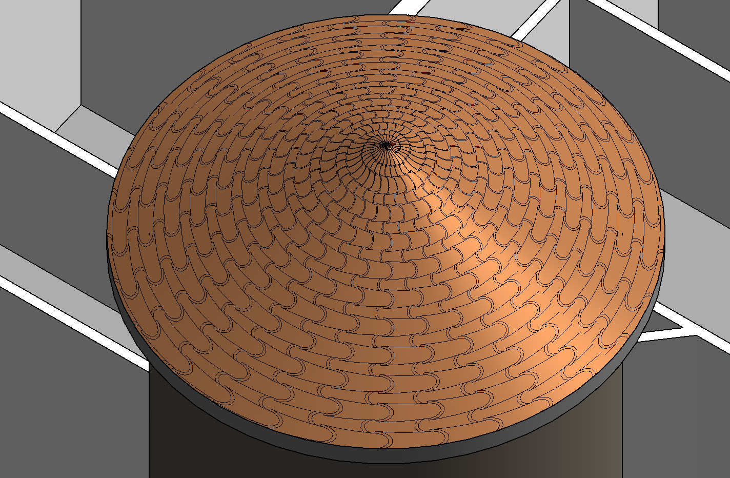

I am trying to hatch the circle roof tiles as shown in image, but I could not find way to correct the mapping result, is there any suggestion?
Thank you.

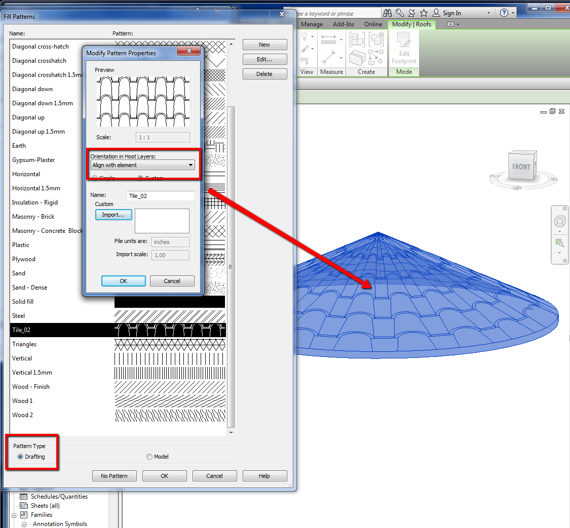

Did you try "Drafting" pattern instead of Model?
