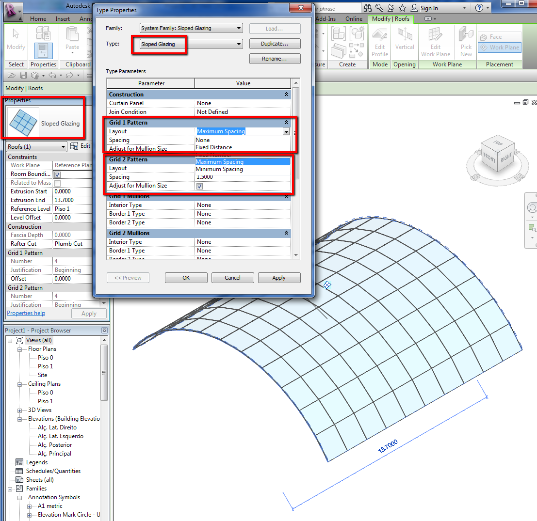

Hello.. iin need of a little help here... I'm a BIM student working on creating a small strip mall. I was wanting to put a seamless roof on my building.  I'm getting kinda frustrated cause i'm trying to make my roof look seemless using the slope glazing. Every time i do it comes in flat and not molding the the work plan. I had it working on monday and not sure how i did it.. any help would be awesome.

Select that "Sloped Glazing" go to properties and change the "grid" lines like you need.

Thanks Typhoo, Altough i had worked with those prior to me asking, your image got me thinking and was able to figure out a solution... although it's kind of sad that you can't have one set of of grid lines to make a curved roof. :/

You want a curved roof, with glass material but without the gridlines? simple, create a "Roof Extrusion" with glass material and with thickness you want.
