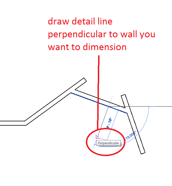

Hi guys, another simple question apologies, IM tring to dimension 2 points on the same wall but aligned dimension wont work as it only lets me dimsion the face of walls and not points in walls and since the wall is not at a right angle to the adjoining wall the dimension wont be correct, ive included a PDF of the 2 points I need to dimension. Thanks

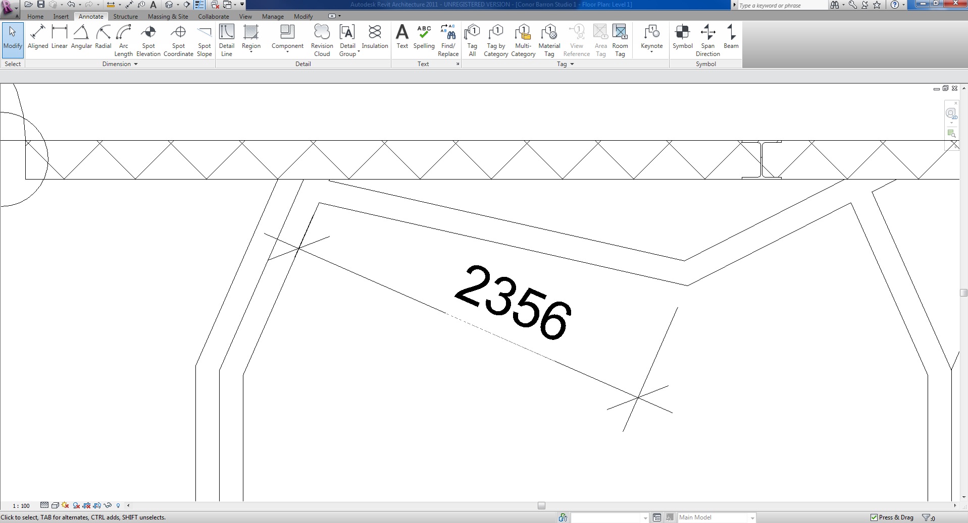

Simply start your dimension and tab until you get the point at those intersections.

You have to tab select at both points/

You have not used the process I described.   You have to tab select the point at each end.  You started with a face - not a point.  Try it again.

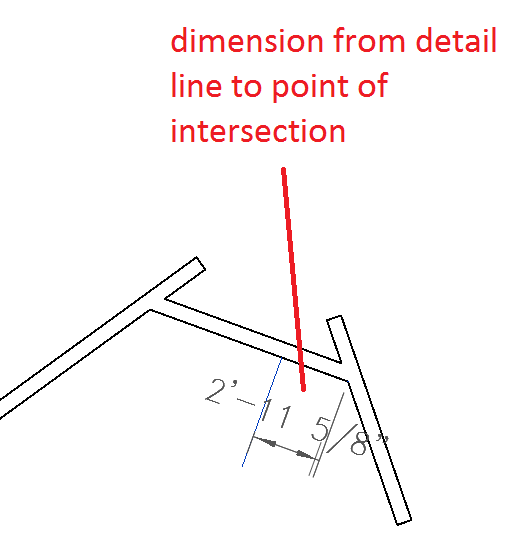

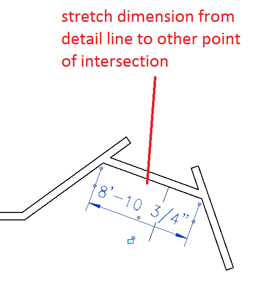

here is what I would have done
