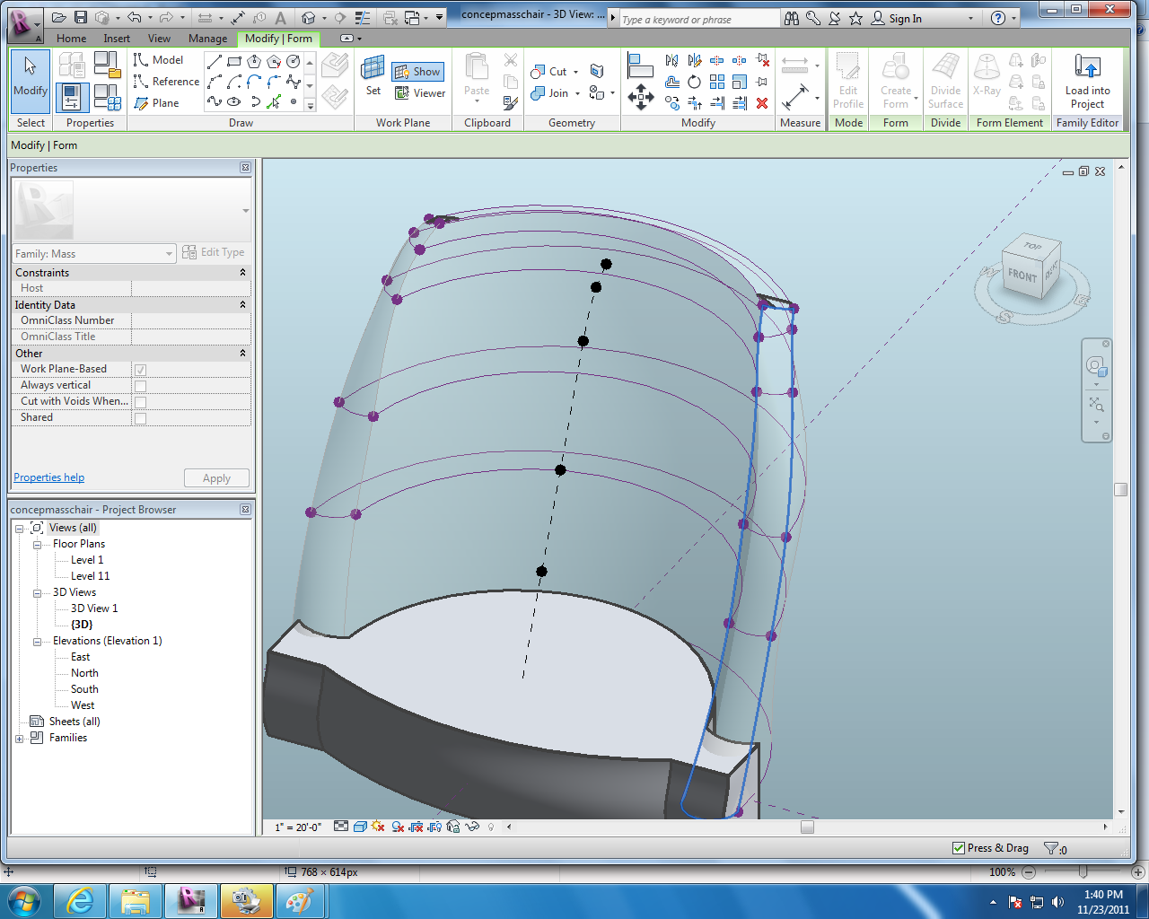

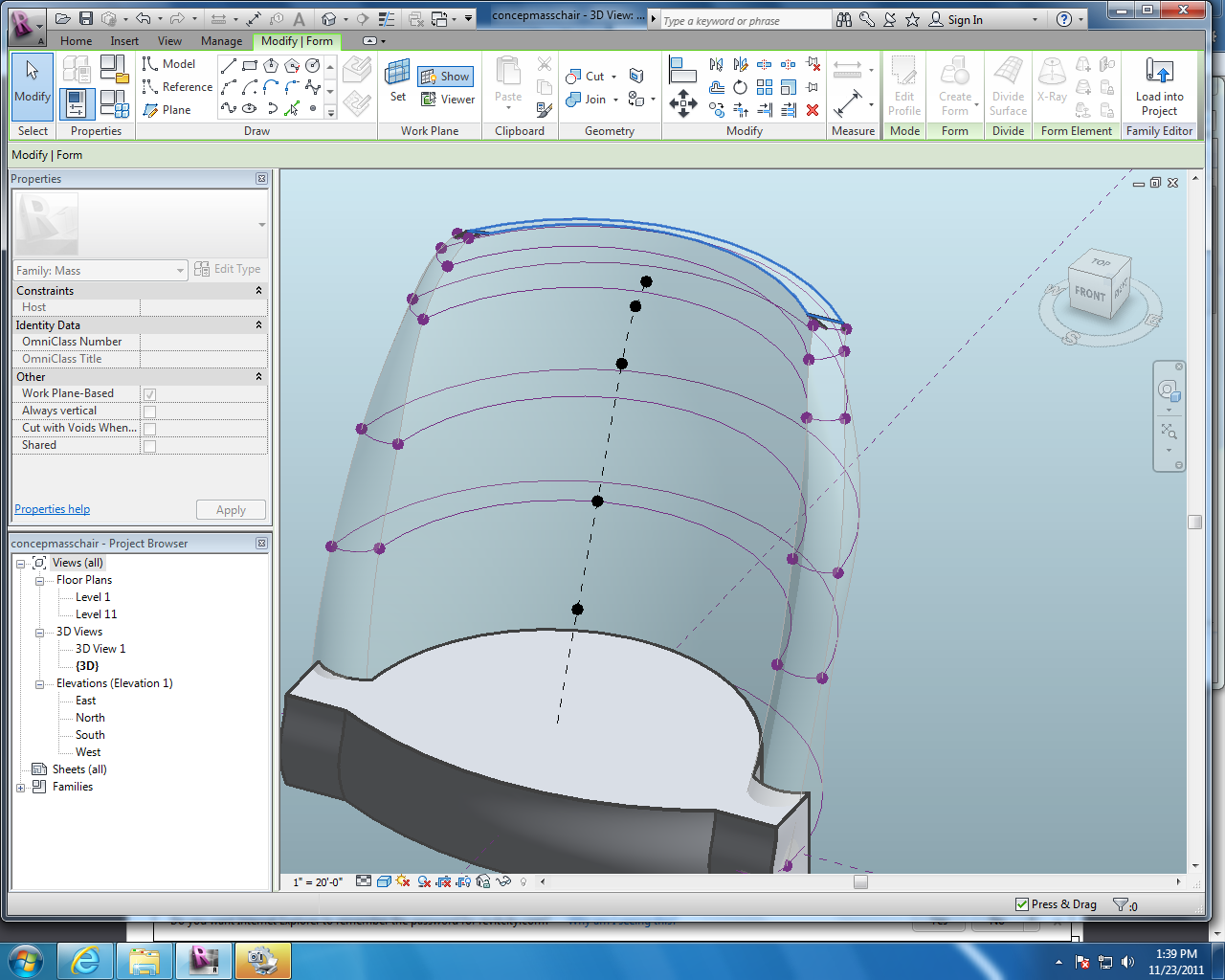

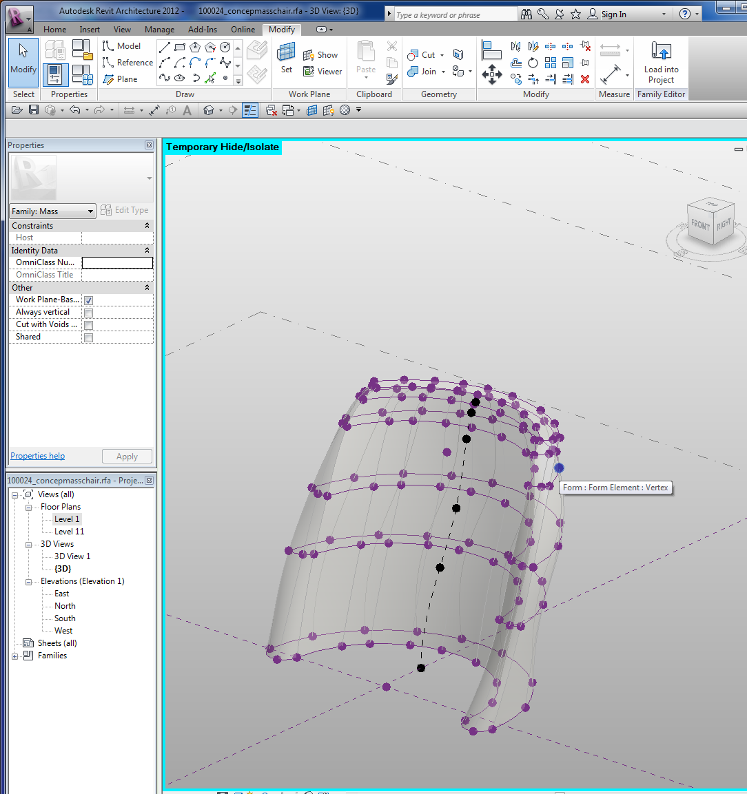

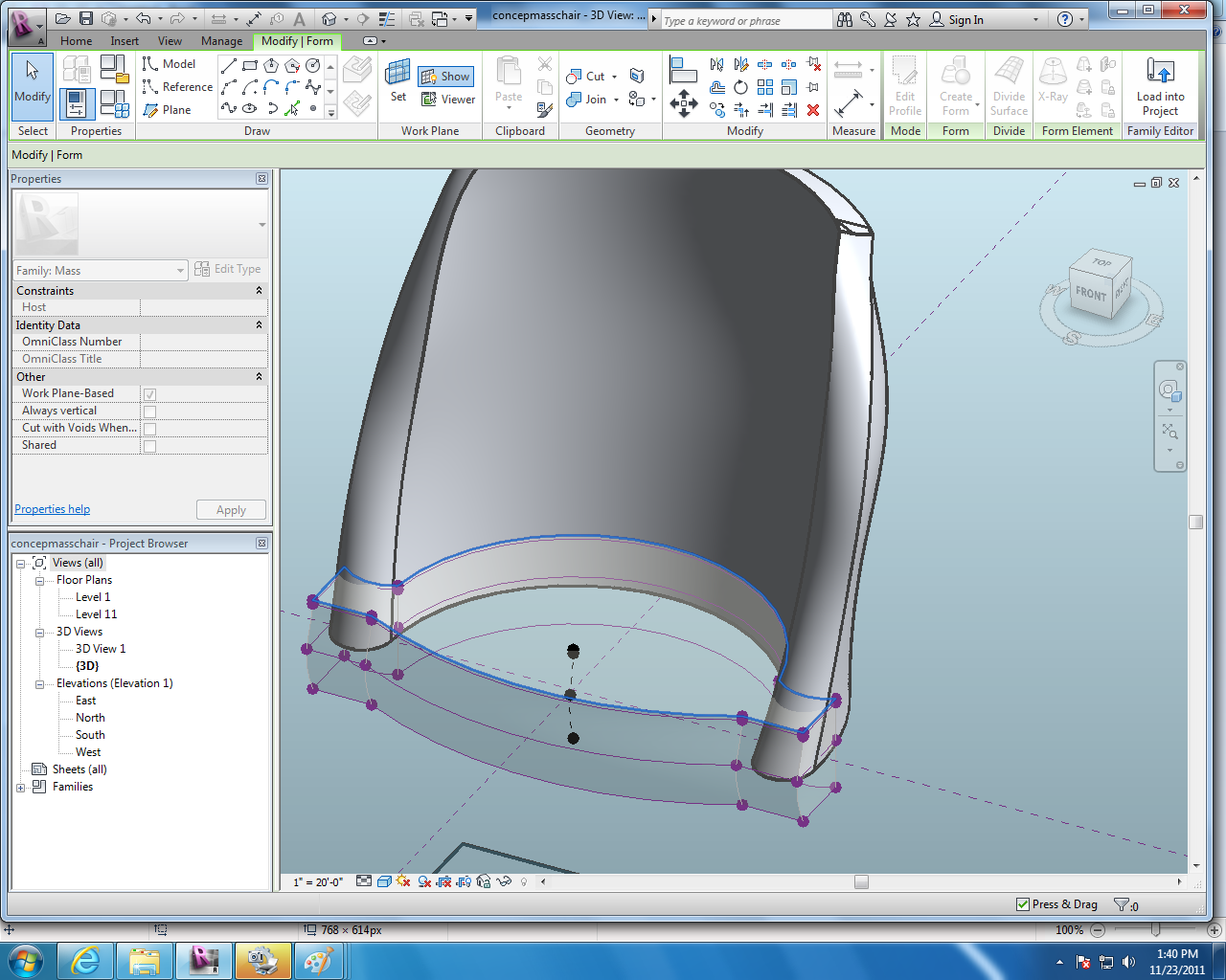

Here's the file and some pics of what I'm having trouble with.
I can add an edge to the sides of the seat, but not to the top of the seat. And I can't add edges to the whole backrest. Profiles are okay though.

Select the object, click on "Dissolve", select again those lines and click on "create form" now you can add the edges.
