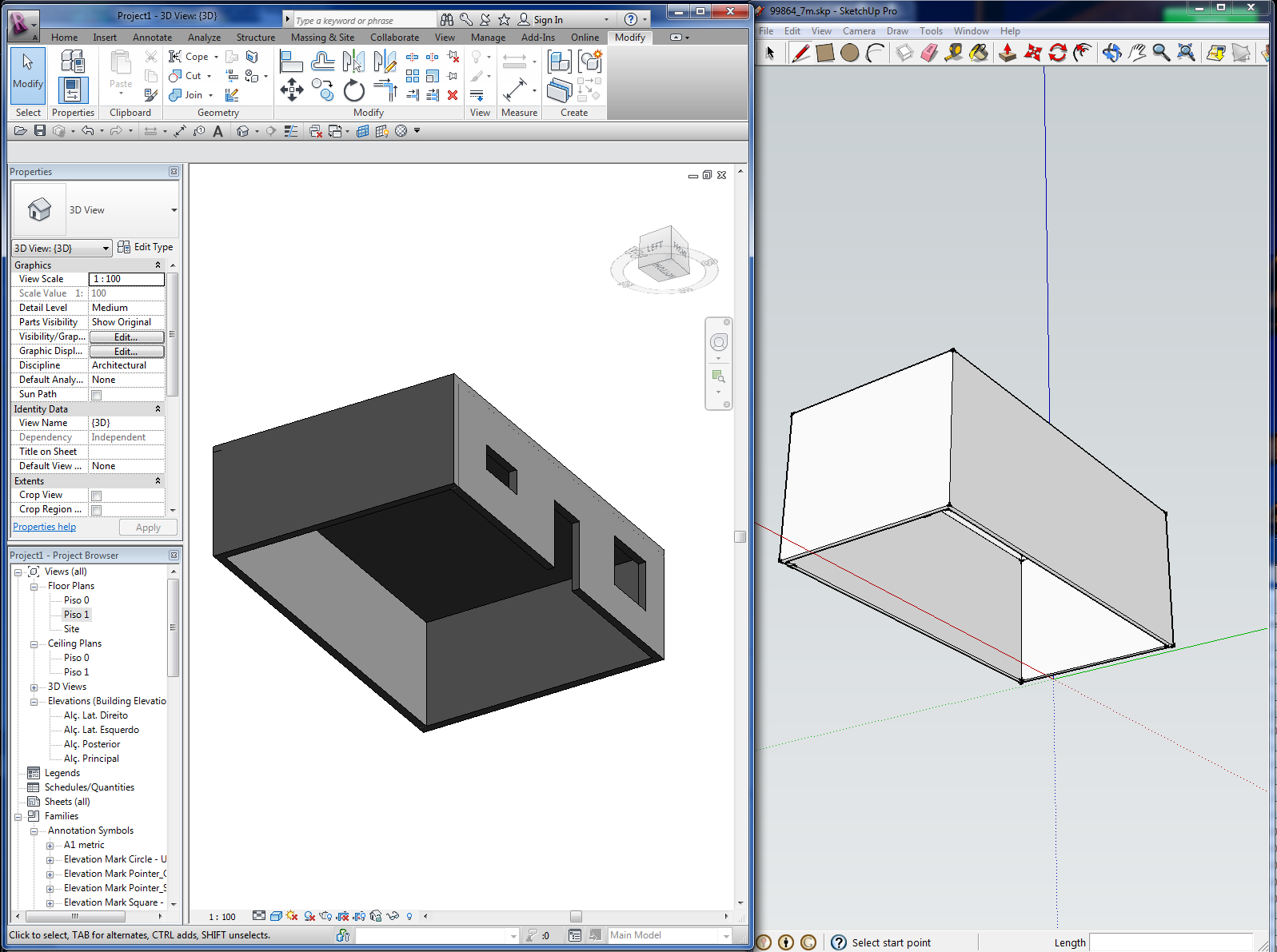

To create that in SK you can easly do that in Revit, what do you think?
