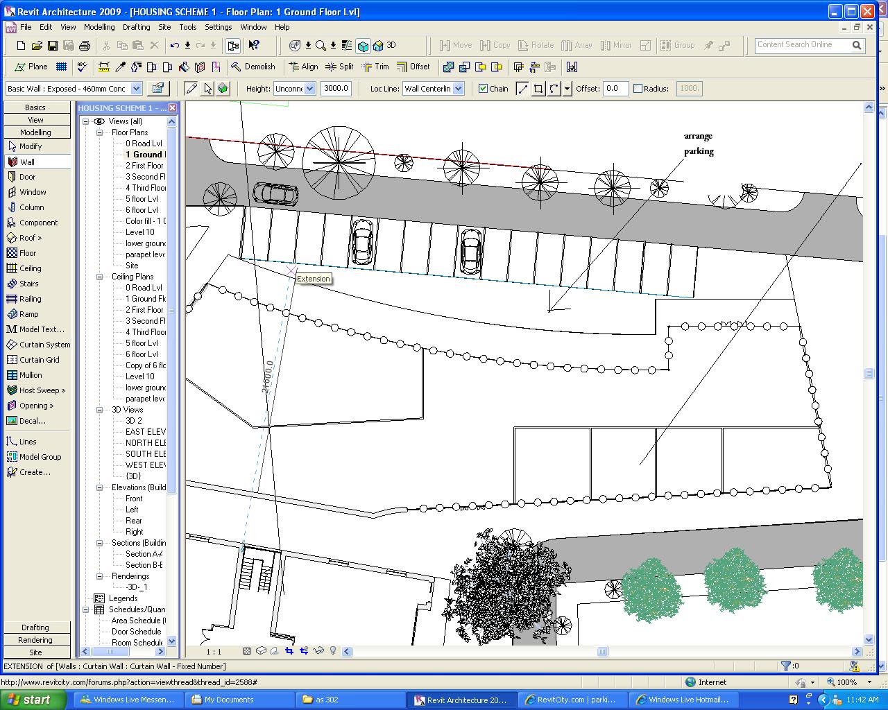

Sat, Oct 3, 2009 at 10:49:36 PM | parking in a radial
Mufu
Joined: Sun, Apr 19, 2009
25 Posts
hi guys i have been away for long but i have a question i would like to arrange my propsed parking in a radial or in other words in an arch form plzz would like to be adviced on that and as always its an urgent case as i have to submit my proposal very soon,including an image to aid understanding thanking you in advance
