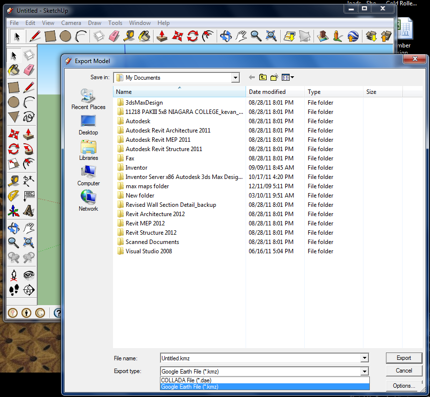

Hey guys! I am currently working on a scale model of a new building we are designing in Detroit and we need to incorporate buildings and the city block design into our model. Is it possible to scan this from Google Earth into Revit or another program so that we can print out the city block in scale to help build our model? Let me know if you have any suggestions!

We aren't building a model for Google Earth. We are designing a project bid and need the block design from Google Earth or a smiliar program to build a scale model for our presentation.

I work alot with buildings in Google Earth. You can't just upload a city block from google earth, you'd have to individually download each building from the 3D warehouse and then import them into your Revit model but I doubt it would keep the face imagry. If you want to keep in it within Revit, I'd recommend modelling them each yourself but just leave them generic. Try to recreate what they do in this video for Vasari... http://labs.autodesk.com/utilities/vasari/
If it were me, I'd would just export your model into sketchup and then export it to a Google Earth .kmz file for presentation purposes. This doesn't make it a permanent part of the Google Earth buildings layers, its just on your local.
