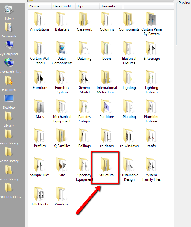

Hi, I have revit arch. and there are no structure families, no braces, no trusses, no foundations ... can I take them from revit structure? witch of them have a lot of that kind of families 2012/2009? , are its parametrical adjustables there?

When you go to "structure" tab and you select "Beam", "Wall", "Column" and so on you have a "Load Family" button where you can select in "Structural" folder what you need.

The default location in RAC 2012 is C:\Programdata\Autodesk\RAC 2012\Libraries\ . . . . .
To a certain degree it depasnds on the version of REVIT you have installed and 'how it got installed'. If you have legitimate software it should install with all the familes required. Otherwise you can append the installation with the Autodesk DVD or USB.
Do a search on your hard drive for *.rfa files and see if they exist. Once you find them you can setup a 'place' in REVIT to make it easier to load them.
If you do not find the *.rfa family files on the hard drive then they do not exist and the installation needs to be appended.

yes thank you, C:\Programdata\Autodesk\RAC 2012\Libraries\.............  that's it

Now you just need to add that folder as a 'Place' or 'Library' folder in REVIT for quick access.

I tried other method, I have reinstalled revit , and after that ,it opened by default the way with all maps ,structural...
