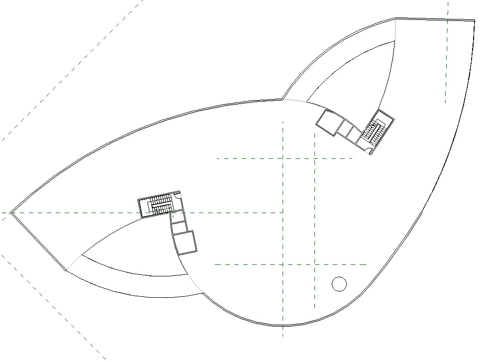

currently I am working on the level 5. I set the underlay  to level 1. but it only show part of the level 1, not the whole level one. the walls seems like break in the middle and lose portion . can anyone help me with it?

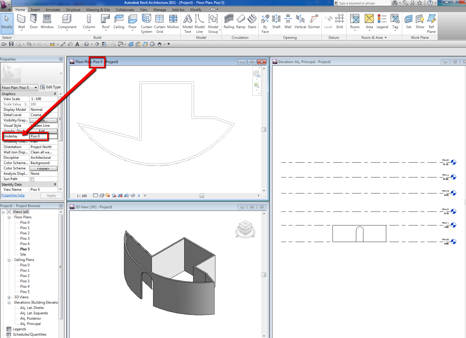

Wierd... I don't have any problem with that, can you post some screenshots with the properties of that view like i posted?

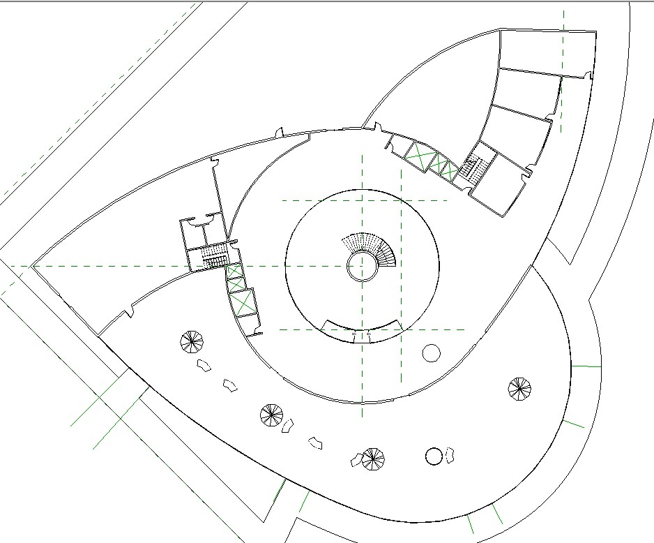

Sun, Nov 13, 2011 at 3:07:59 PM | issue about the underlay
archz
Joined: Tue, Dec 7, 2010
5 Posts
first image is level 1, second is level 10, and the last is the level 10 with the level underlay

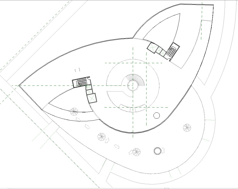

Sun, Nov 13, 2011 at 3:09:46 PM | issue about the underlay
archz
5 Posts
third image is level 10 with level 1 underlay

I can't see but are you in "Hidden Lines" view mode? change to "Wireframe" and check please...

i change to the wire frame and it does show the underlay. thank you. is the underlay only shows in the wireframe mode? is there anyway to show the doors, too?
