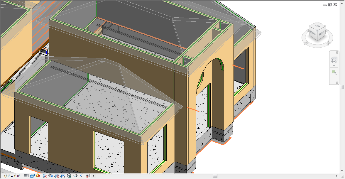

Are you using revit structure? I believe the analytical model of walls would be a single plane. Note the green line along the wall, this is a single plane, the framing members are shown in orange.

I'm using Revit Architecture...any way to do the same there? I can try to obtain Revit structure, but we already have a workflow set up for architecture and admittedly I don't have much experience using either.
