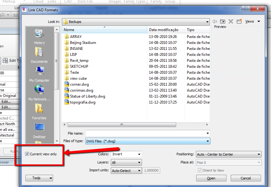

Sometimes when I import a CAD overlay in my Reflected Ceiling plan I get the "None of the created elements are visible in the reflected ceiling plan"
What am I doing wrong?  I am importing it into the right view and have the it turned on.
Thanks.

Just turn ON the "Current View Only", select the file then open.
