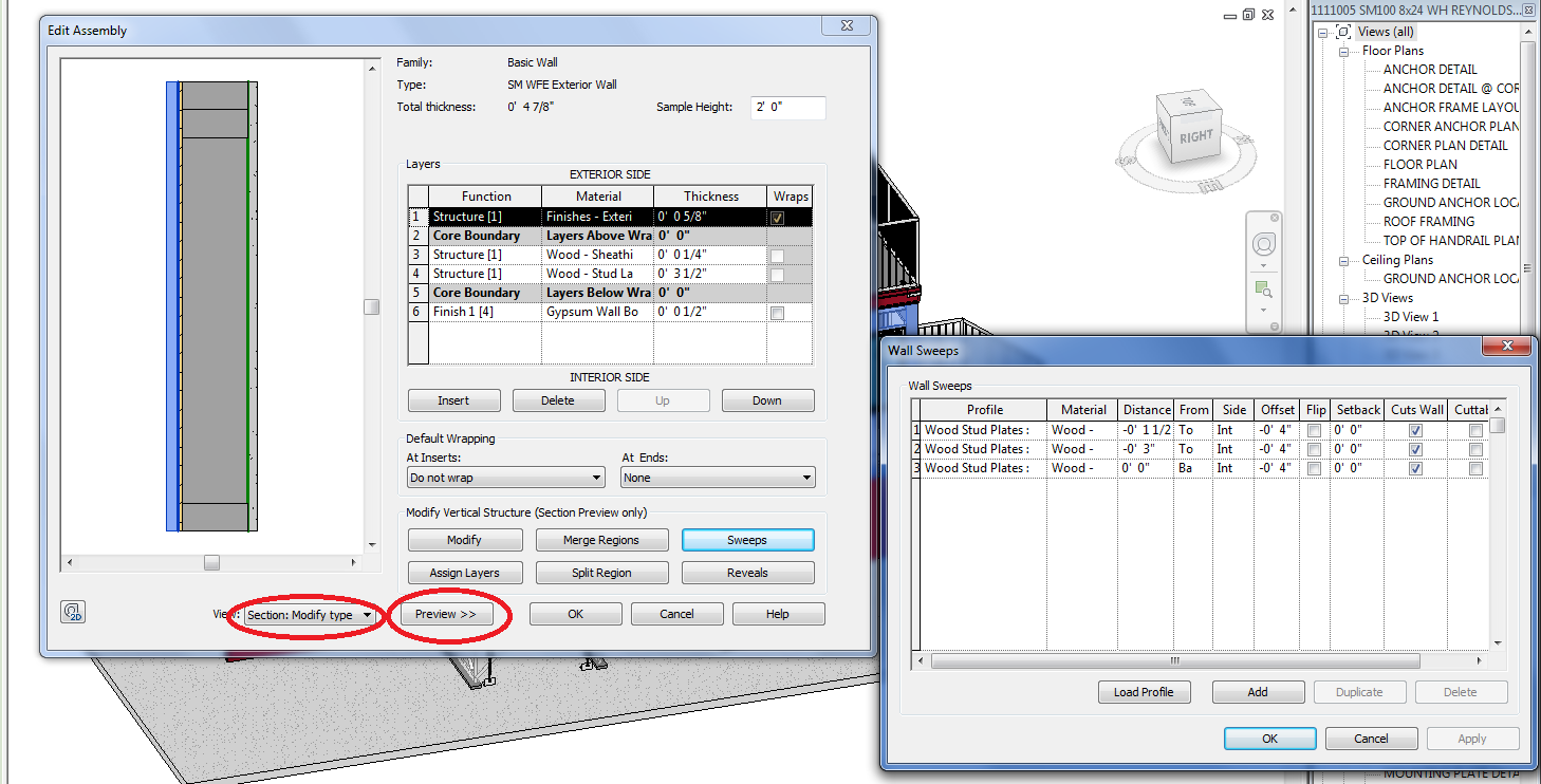

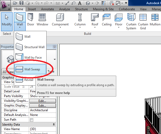

For moulding, there are a few ways. All involve having a profile family loaded into your project.
1. You can build the sweep directly into your wall assembly. As soon as you change your preview window to "section", the sweep dialogue box opens up.
2. Create a wall sweep type and manually place the moulding at each location.
3. Create an 'In-Place' family and create a sweep by sketching the path and applying your profile

I 'm following the first picture you posted and managed to get the sweeps menu. I added a sweep, but it's just a sqaure...
 How do I modify it into the shape that I want?
Also for the second picture, how did you get that option to open up? I selected my wall, and then go to the home tab, and hit the wall pull down menu, but the sweep option is greyed out.

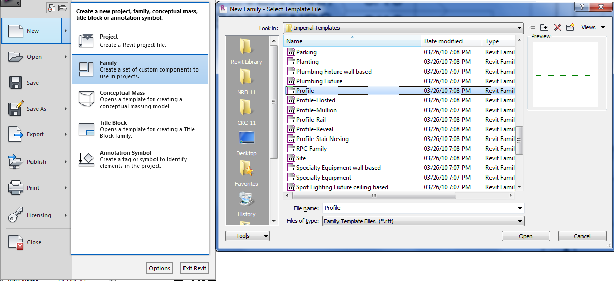

you'll need to create a new custom profile. See attached. Once your done, save it somewhere and then hit "load into project". Once you do this, your custom profile with show up in the pull down list within your sweep editor under Profile.
I'm not sure why your wall sweep tool in greyed out. You don't need to select the wall first, the wall sweep is it own seperate entity, its just hosted by the wall. Try it again without selecting the wall first.

Thanks a lot! I managed to get it to work. I even made a custom molding profile and applied it to my project.
What was holding me back was that I didn't know all the moldings were under "profiles." I honestly never opened up that family group.
And the wall sweep was greyed out because I was in plan view the whole time. The moment I went into 3D, it all cleared up.
