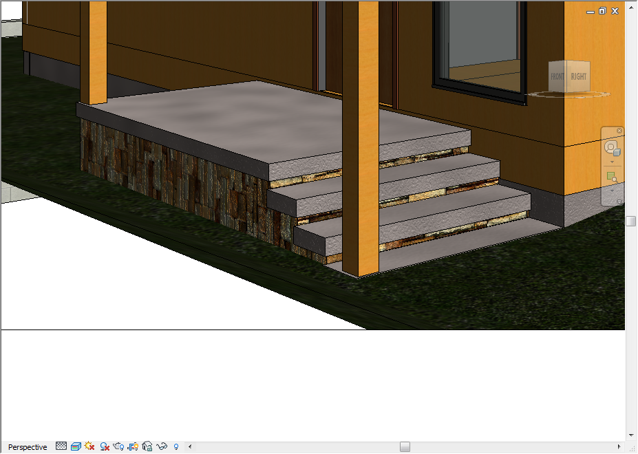

Hi everyone,
Could you provide me with a strategy to create the portion in red in this stair?

You don't create that as a stair item - it has to be a wall or something modeled in place.  Your problem will also be the brick "stringers".
I would model these as walls with the stepped profile sketched in the wall.   I would do the stairs without side stringers so that the treads "sit" on the walls.

Thank you very much I thought about modeling in place, the walls also a bit...
But isn't there something or a button in the satir settings that would get me what I want?

These steps were modeled with floors for the steps which were copied, and walls for the perimeter, and risers.
Stair Stringer Cutting Stair Treads and Risers See Image
