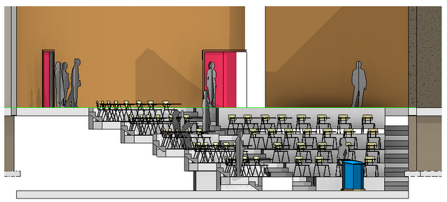

ok guess get me right i am making a multi code building and i want to include theater in that building i could creat any other room store in this mall but i can't creat this auditorium theatre in this building that is my problem, ok see example here

ok this is a clear example of what i am wanting to do? can anyone show me how to do this in revit probably if there is a video of it will make sense more thanks

those are just curved walls and floors and some arrayed components..
maybe some in-place steps copied to the other levels.. 2 minute job..

Sketch eacch "floor" (seating tier) as a seperate floor with an offset off your main level.  That could be up or down depending on the floor level you work from.  In this case, I would think your floor level is the level with the doors and the tiers step down.  You would add curved wall between these tiers.  And you would add the stairs one at a time from tier to tier.  Array your seating using a polar array.

Eniak, what's your timeline like? I have a deadlien to get out this morning but would like to make a couple of videos for you.

hello rkitect thanks for your concern but if you could make it anytime from now till sunday night , i will be so happy for that

I will post these as I complete them. Feel free to ask questions.
http://gibsonhh.info:8081/revit/video/Theater_Floors.swf

Walls: http://gibsonhh.info:8081/revit/video/Theater_Walls.swf
