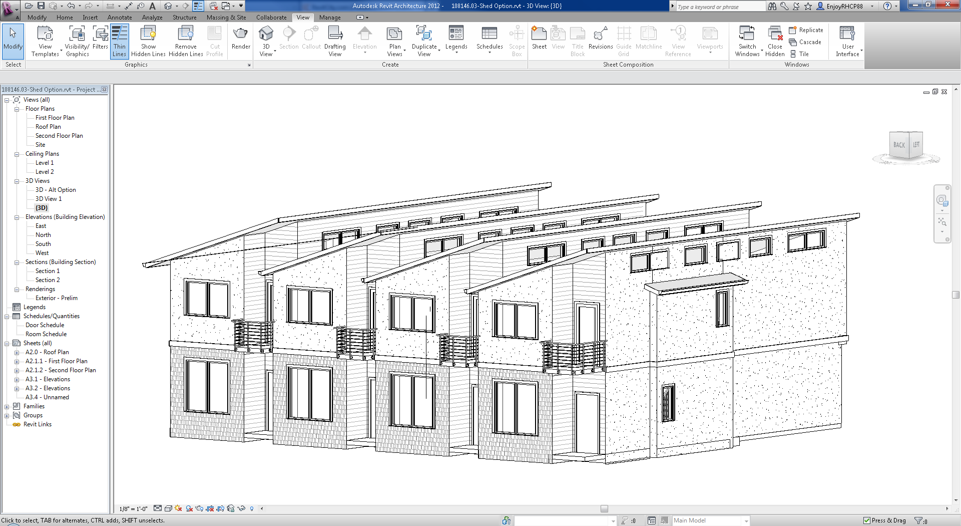

Hey all,
I have a window that is hosted on a wall but also cuts into a seperate wall type.  While it cuts through the hosted wall fine, the second
wall still shows up.  I guess my question is, is there a way to host a wall based element to 2 hosts? I have tried using
cut geometry, but no luck.
If anyone has any suggestions I would greatly appreciate it!
Thu, Oct 27, 2011 at 7:20:43 AM | Wall hosted familes cutting through 2 types of walls
Join the two walls and the window will cut both no matter which one hosts it.

Awesome, works perfect!
Thanks
