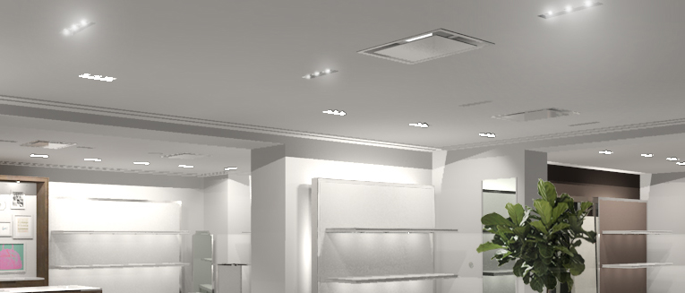

This is also extremely easy to PhotoShop, and often times more realistic. Check out the example from a previous project of mine...
Light source inside the light fixture
