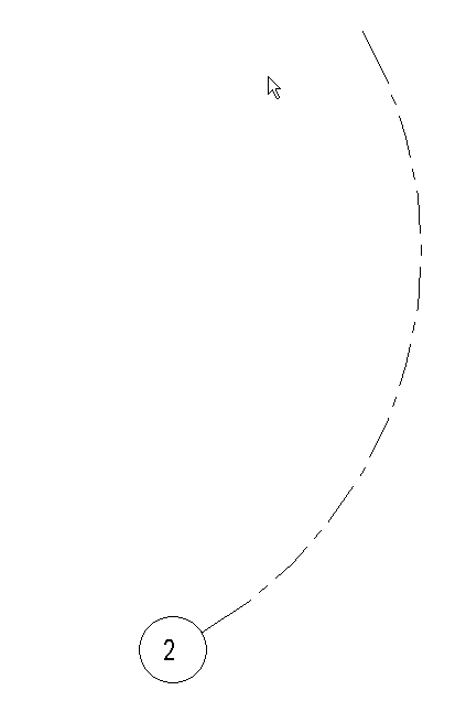

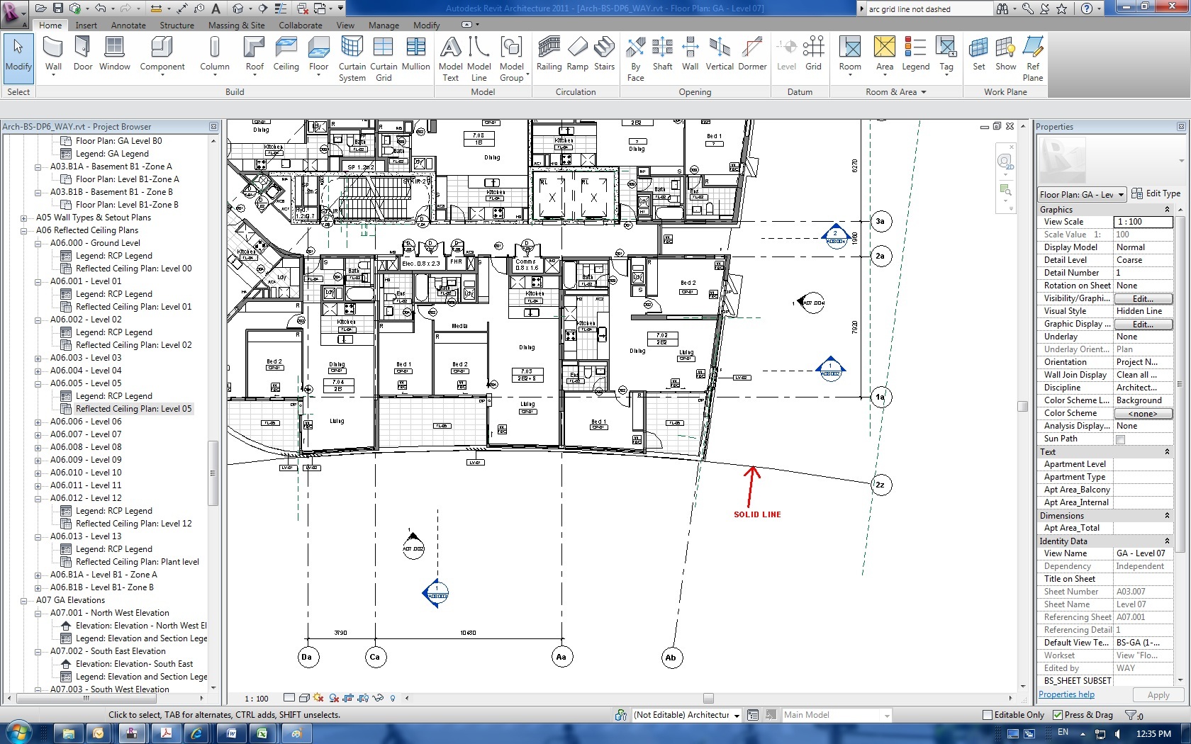

Hi,
Does anyone know why curved grid lines do not display normal grid line linetype (centreline) - instead they only display as solid line?  Is this standard?
I have both straight and curved grid lines in my model so two different linetypes looks terrible graphically.
Object style override makes the grid bubble dashed as well as the grid line - so this isn't a viable workaround.
Thanks in advance.
Amy

You have done something wrong, mine works fine - see attached.

Thanks for the suggestion - grid line type properties only have an option to select a direct 'line pattern' - not a named 'line type'.  So this is all correct in the model at the moment.  It's set to a centreline pattern.
The problem is that straight grid lines display the correct grid pattern, but arc/curved grid lines do not, per the screenshot in my initial post.

Solved.
'End segment grid line' in the grid line type properties has to be set to the same line type as 'centre segment line type' for a curved grid line to work.
