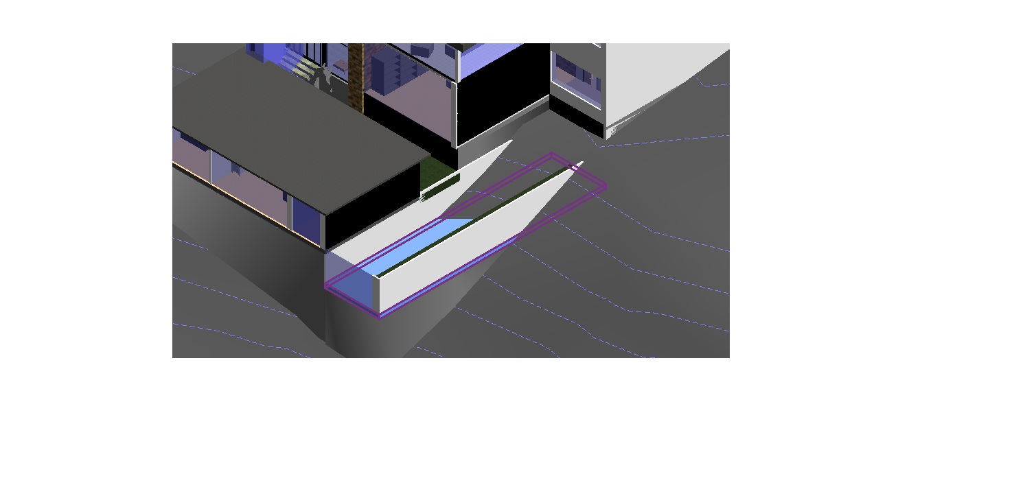

Hello, I'm relatively new to Autodesk Revit, and while I've had experience with it at architectual firms I am still discovering how to correctly use the program. I am currently working on a project in Autodesk Revit 2011 Student Edition and have encountered a problem with Site Pads; the pad (shown blue, in attached) doesn't cut through the typography; and thus depriving me of finishing the project. The typography was created within Revit. Does anyone know how I can fix this? If you require further detail please ask.

Do you have graded regions / sub regions or is this one topography?

Do you have 2 (two) Topos on that project?

Hello,
Thanks for getting back to me, I recently found out how to fix the problem. I just split the topography.
Much thanks for enquiring.
