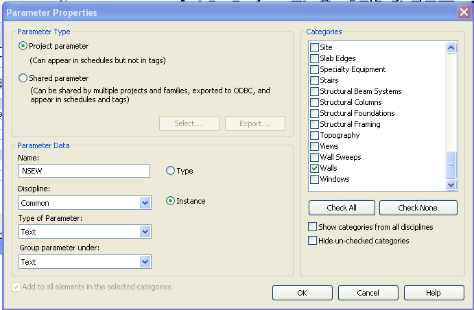

First, the NSEW parameter should be instance, not type.  See attached.

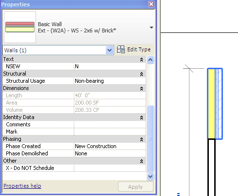

Second, it appears that as long as the stacked wall is "stacked", you can not change the instance parameter of the individual components.   SO!!! Right click on the wall and choose break up.  Now you can assign NSEW - see attached:
