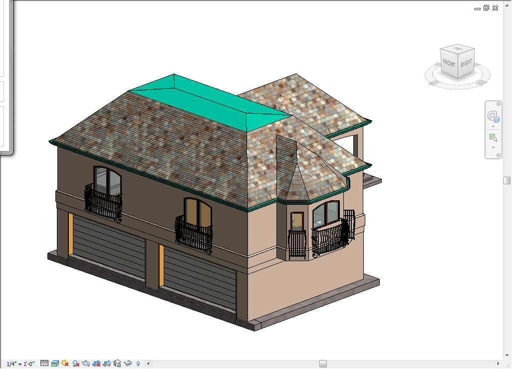

In my 3 years that I have been doing REVIT this is the first time I have run into this problem.  (V-2012 Arch).
I have searched the threads and seen similar questions but the responses have not worked.  Doing a prelim
Barn design for a project and can not get (see attached) Roof 1 to join roof 2.  I have have tried multiple possibilities
including Changing pitch, roof types, intersection heights, offsets etc... to no evail.  I get a myriad of errors including the
2nd jpg.  I need this on the front and both ends.  I have tried using a complete boundary and each side also.
Any help would be greatly appreciated.

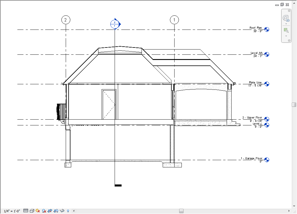

For construction of multi pitched roof, the one attached, was created by footprint, and setting a top limit in theroof properties box of level AA. Then a second roof was constructed above it using level AA as the view level, with a very flat pitch.
