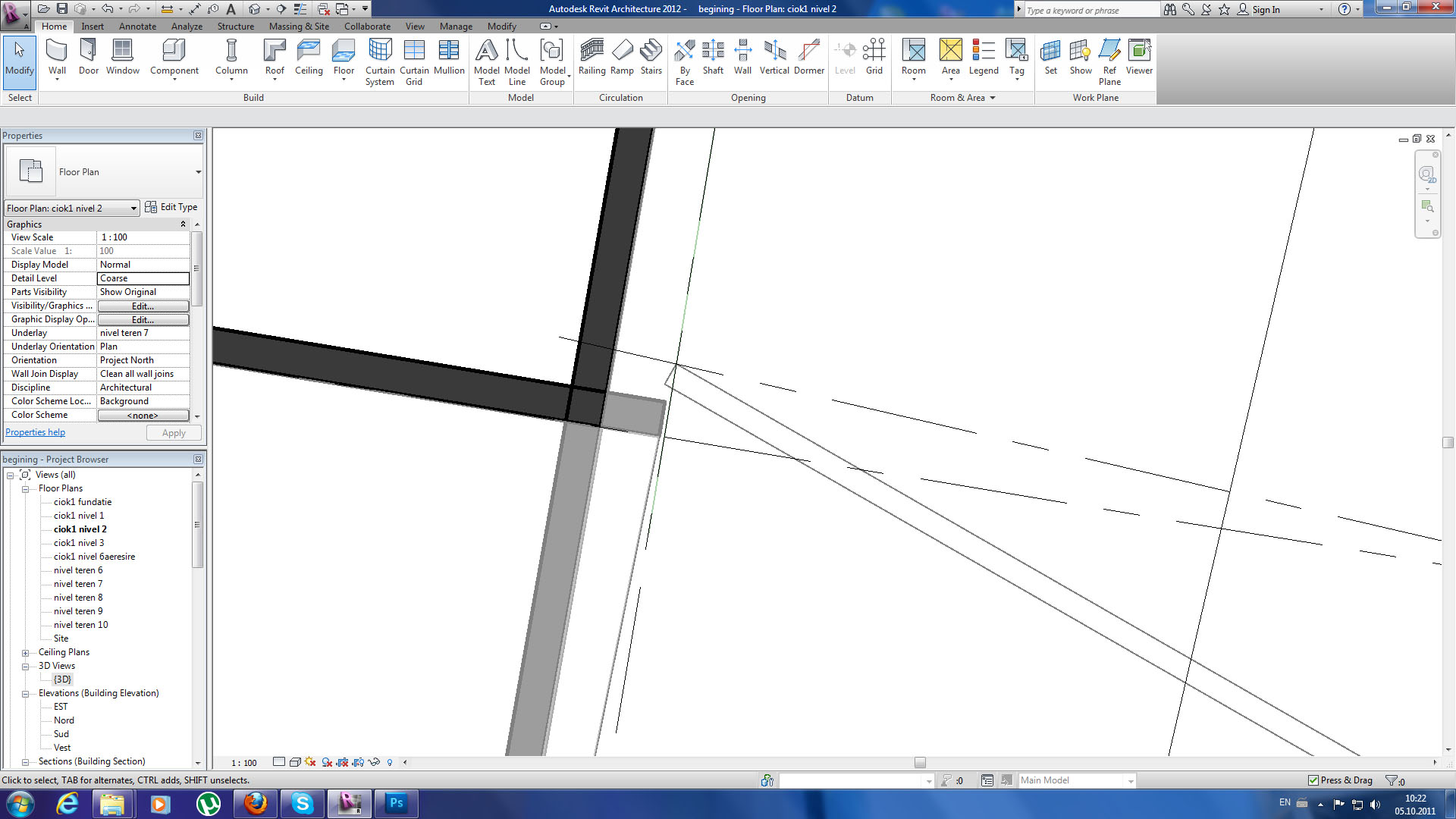

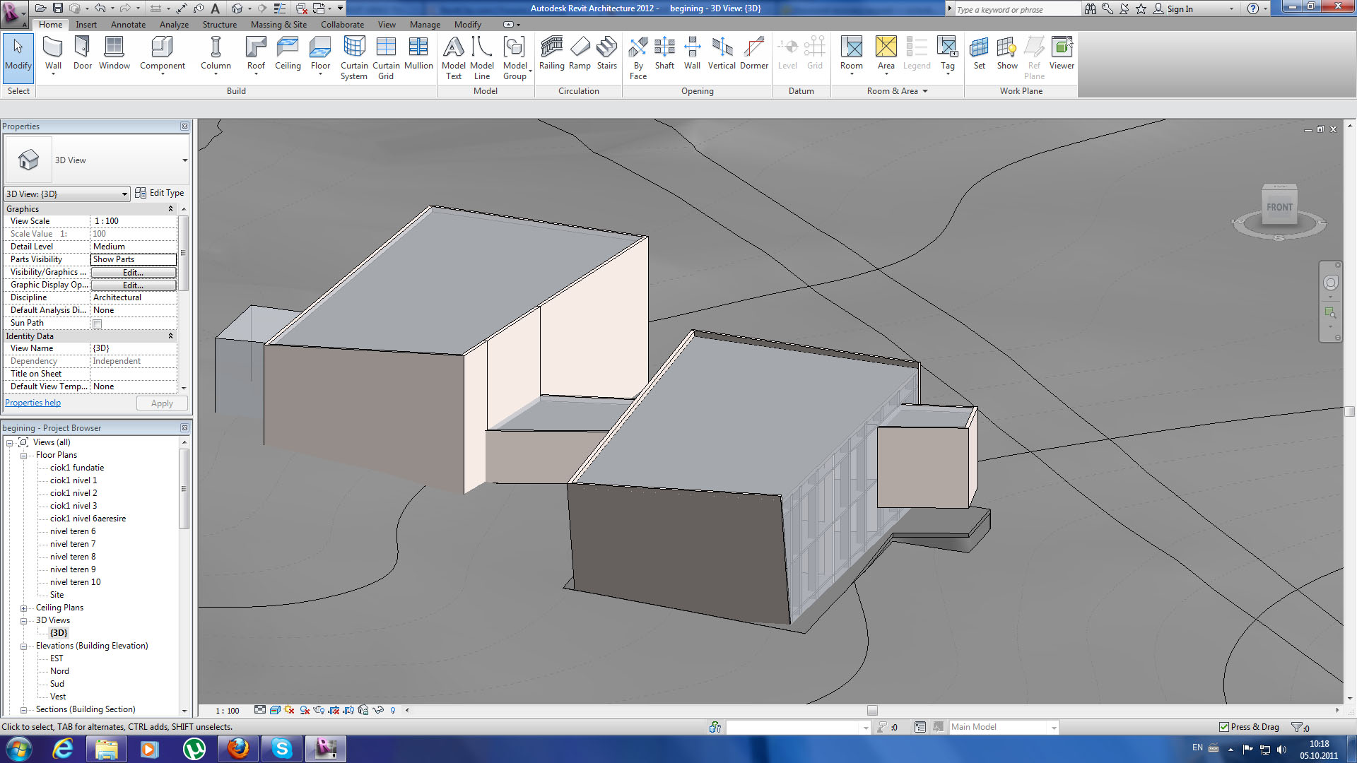

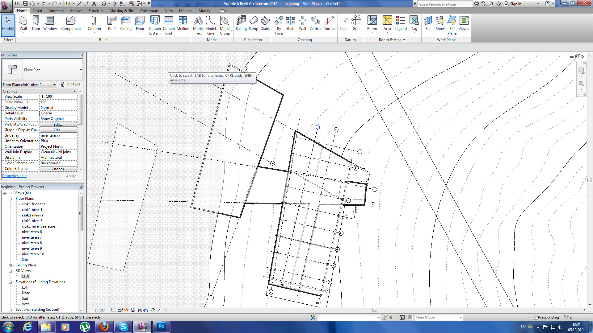

1  what is the best way to join exterior walls of 2 in place masses, with different heights and angles
http://imageshack.us/photo/my-images/33/57018760.jpg/
http://imageshack.us/photo/my-images/20/54416137.jpg/
http://imageshack.us/photo/my-images/694/73846332.jpg/

masses are intersected, and walls too, if I trim extend to corner , it cuts the bigger wall by all the height

this form could have been made by just using standard walls, I believe you can edit the walls like normal, so create a workplane at the face of the walls, name it, then use the framing view tool to create a view directly at the wall surface. then you should be able to cut the holes needed to create what you want.

OK, THANKS , i MADE INTERSECTION OF 2 INPLACES, JOINED THEM AN THEN REFRESHED THE WALL TO THE NEW FACE WITH HOLE
