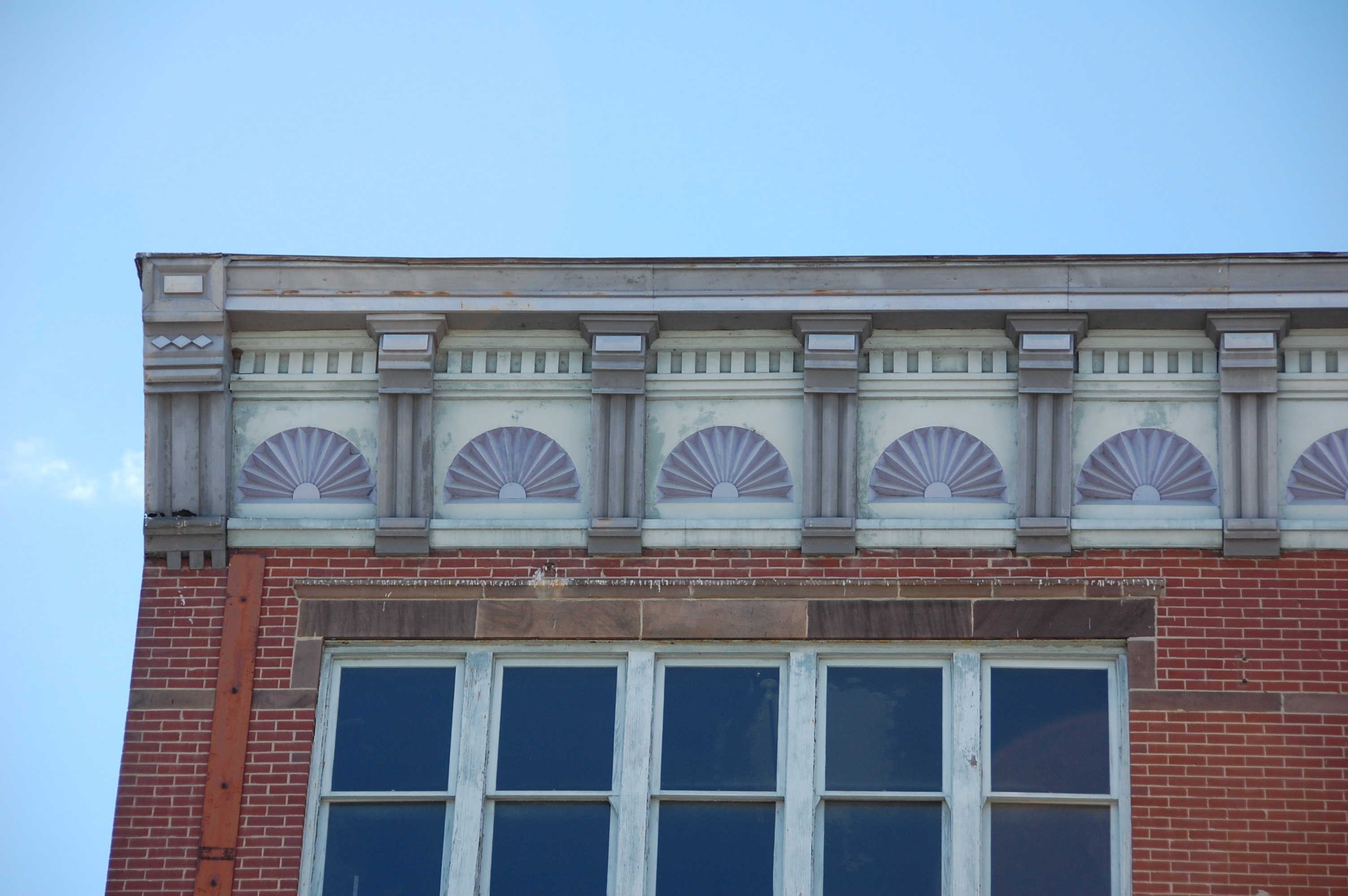

Modeling a turn-of-the-century building in Revit for a rehab project.  Need to have all exterior elements in the model/elevations for the historic review board.  Any ideas/suggestions on how to create this?

...Personally, I would model that cornice as a curtain panel.  I see: One radial array of blends.  One horizontal sweep with multiple profiles.  One flat plane, which I would probably model as a sweep.  Another blend for the column, where the panels should begin repeating... a single vertical extrusion for the bricks at the top...
I count 10 or 11 various geometries needed to make that so it'll tile nicely.    That's not so bad!

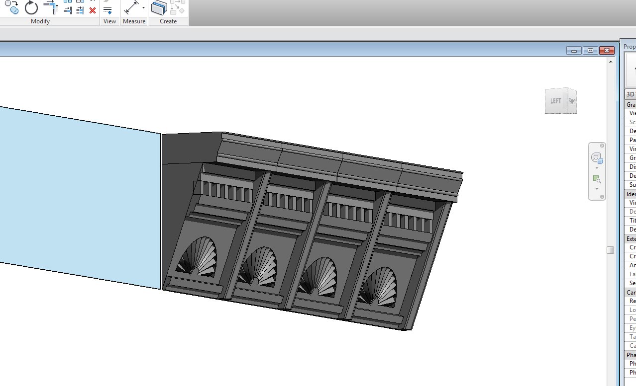

Okay, I got an itch to model this over lunch.
This is really rough and faked in.  But its' a start, and a proof of concept.  Took about half an hour.   If you're using 2012, help yourself to the panel family.

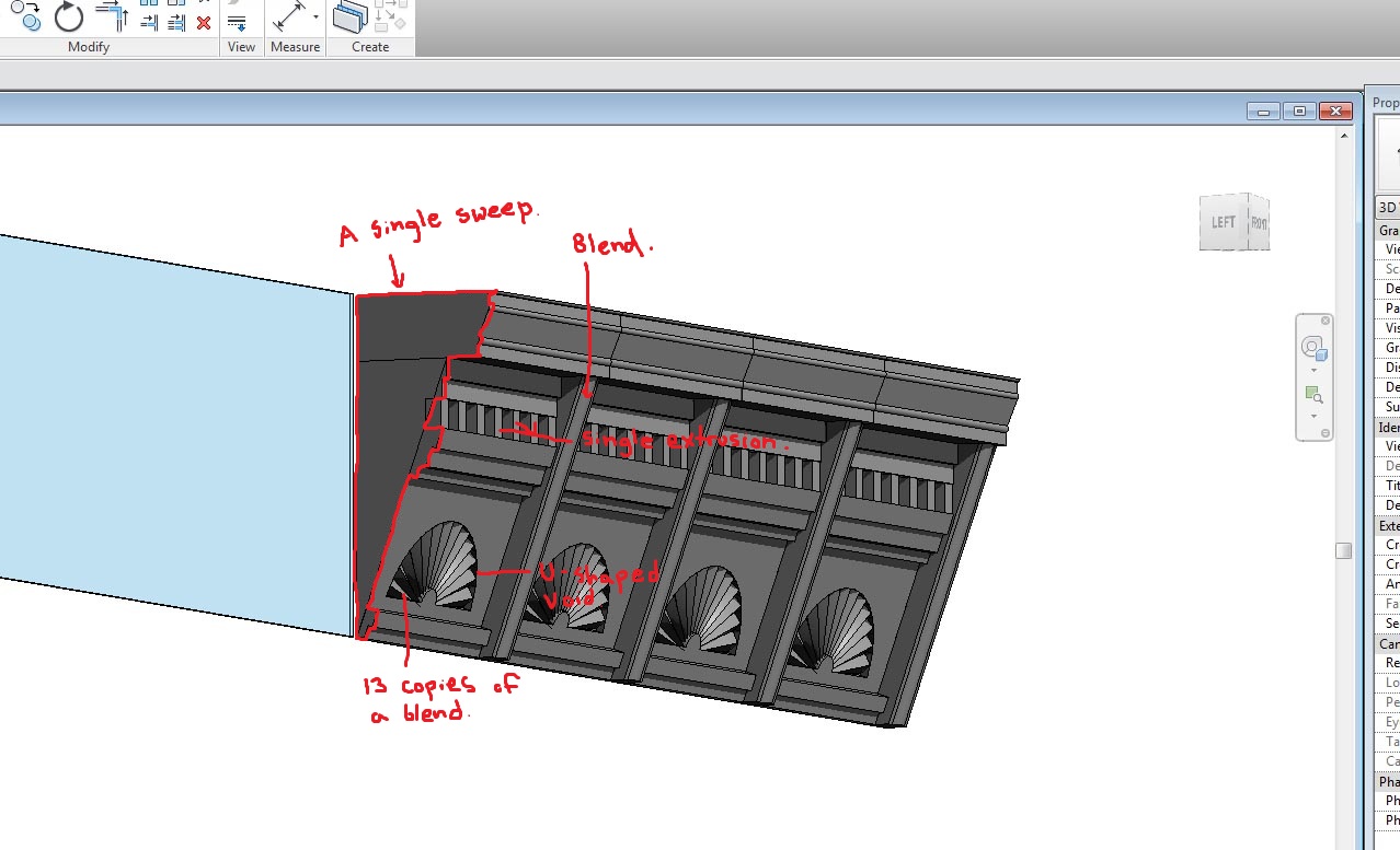

Basically, start a new family with the "curtain panel" template.  Make sure the widths (left/right refplanes) and height are correct before starting... I messed this up a little.  (ultimately you'll have your curtain wall grid lines at this same spacing) Next, it's just a matter of making sweeps and extrusions and blends.  Copying and pasting them around.  The "fan" is made up of blends.  A radial array went insane, so I just copied and rotated them.  They're buried in the slanted sweep--and exposed with a void extrusion that cuts the sweep only.
One confusing bit was making a new reference plane for the slanted face, on which the fan and the void is hosted.  You can orient a 3d view to a face or plane, to make work easier though.
Attached is a sloppily annotated picture.  At home I don't have anything better than MS paint.
Hope that helps.  I find that family-building really opens up a lot of potential in revit.  The included tools and families cover 95% of everything you need to do, but then with the modeling tools you can make anything you dream of.
Edit:  The fan is made with swept blends, not blends.
