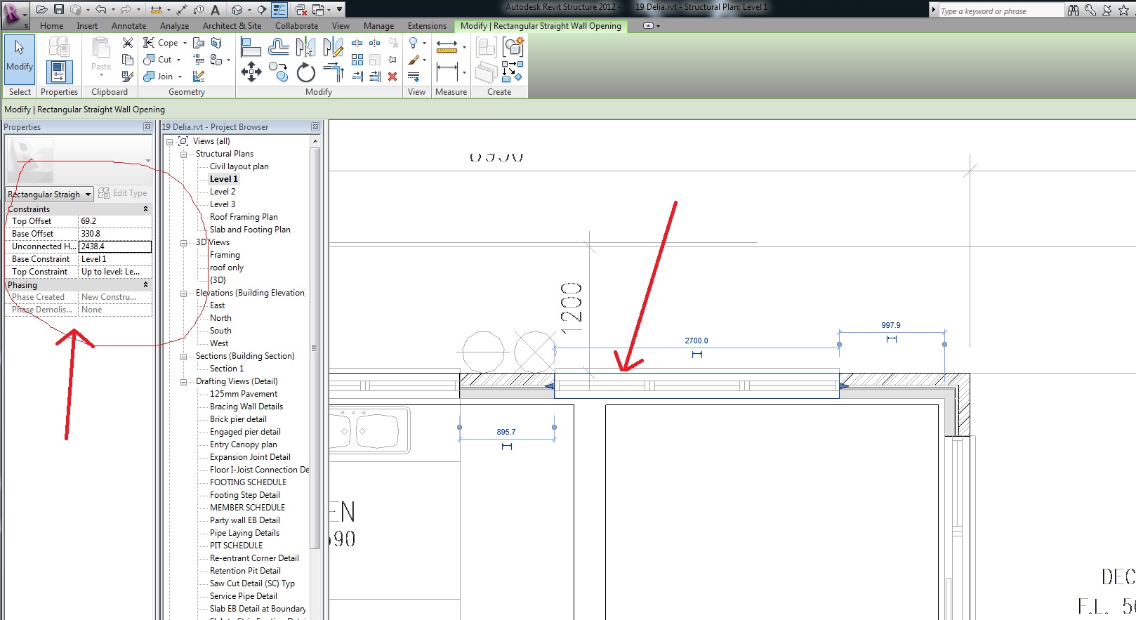

When I create a wall opening, its top and base offsets default to a value that comes from some mystery value. I get the error "opening does not cut its host" because the default values are (in this case) some 3m above the wall. I can change the opening with no problem by selecting the opening and changing the top and base offset values, however I dont want to do this for every new opening.
How do I change the default values so that when i create an opening it will default to what I want (say top offset -450 and base offset 1200?)

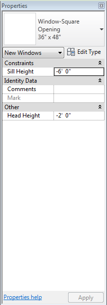

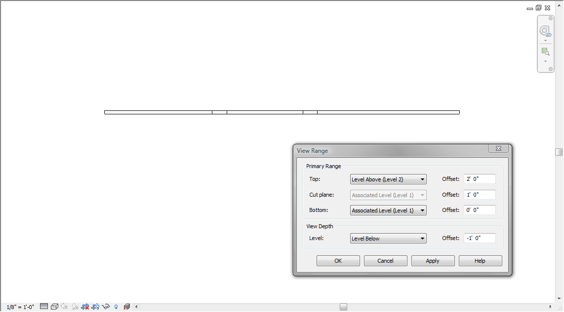

You are using RST. The window opening tool is an architectural tool it is a family set up to work from the bottom up. I expect that you are using the more standard settings for structural which is to look down, and build down that is you are on the layer above and want to place your window in the floor below. The architectural window opening wants to place it above the level that you are viewing. So, you can modify the view property bar see attached which will allow you to place like the architect would, or you can modify the window opening to place the head height below the level you are placing on. in order to see the window being placed you can set the graphic display to wireframe which allows you to see through the wall.

Tue, Oct 4, 2011 at 7:46:11 PM | Wall openings
mbsteve
mbsteve Avatar
Joined: Fri, Sep 22, 2006
759 Posts
4 Stars: 13 Votes
there

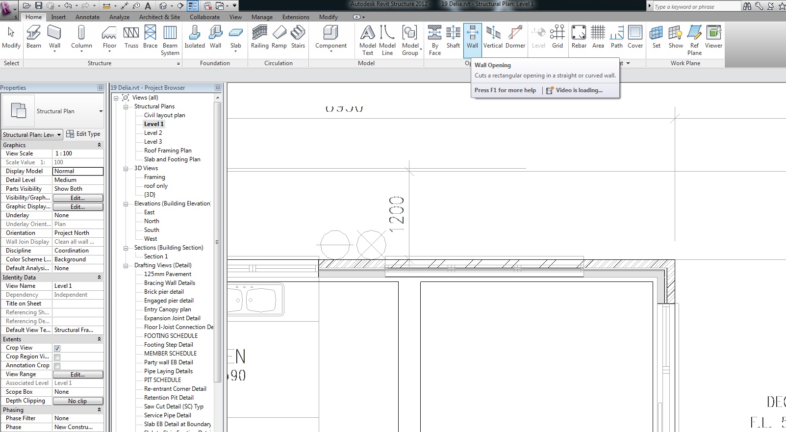

I am using the wall opening tool, not the architect window tool. I have attached some screen shots to hopefully explain better. In the secon shot, you can see the properties box. This box only appears when you select the opening. It does not appear before you create the opeining. I want to change the default values that appear in this box. In this case, the values of 69.2 for top offset and 330.8 for base offset just appear. I can change them to my required -450 and 1200 respectively, but how can i make them default to -450 and 1200?

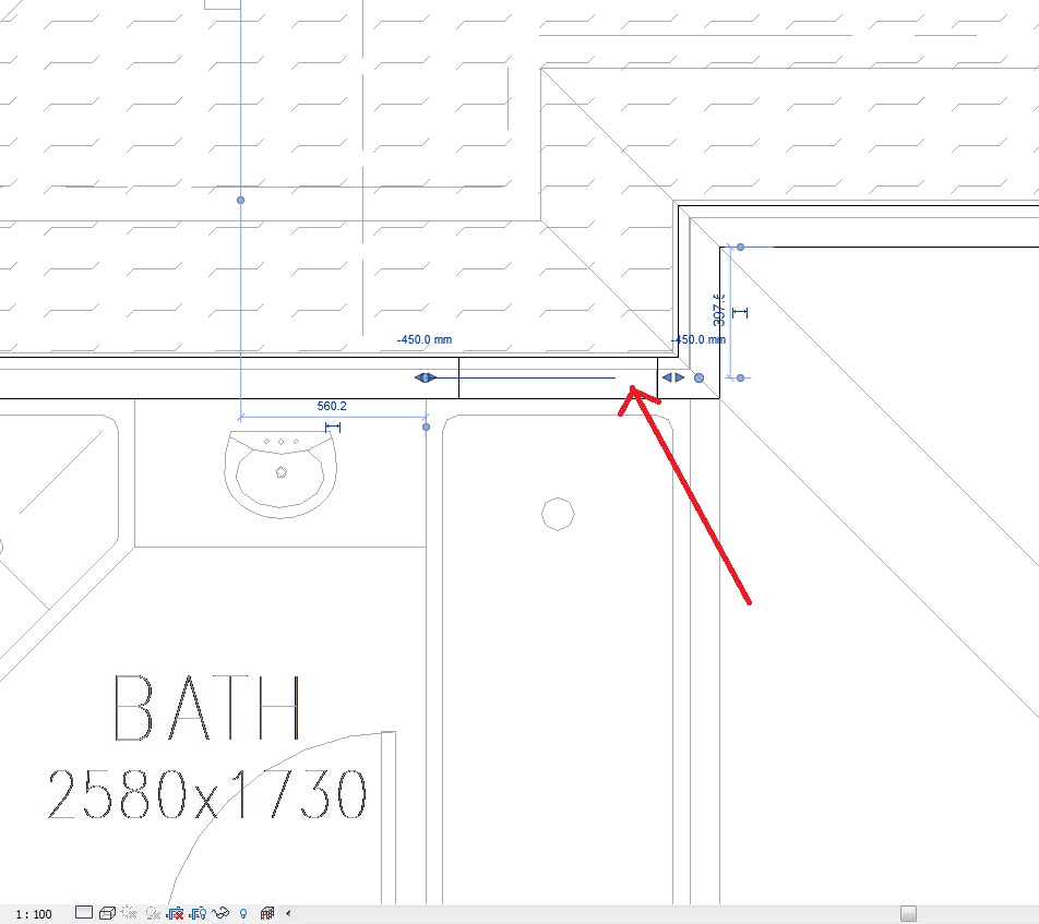

And while we're at it, why does coarse view shorten the view of framing members. It seems to happen at corners mostly. See attached picture. Its very anoying as i need to draw an annotation line over the top of the member to show its full extent. Yes, the full extent shows up in medium or fine detail levels, but that does not suit the structural drawing style.
