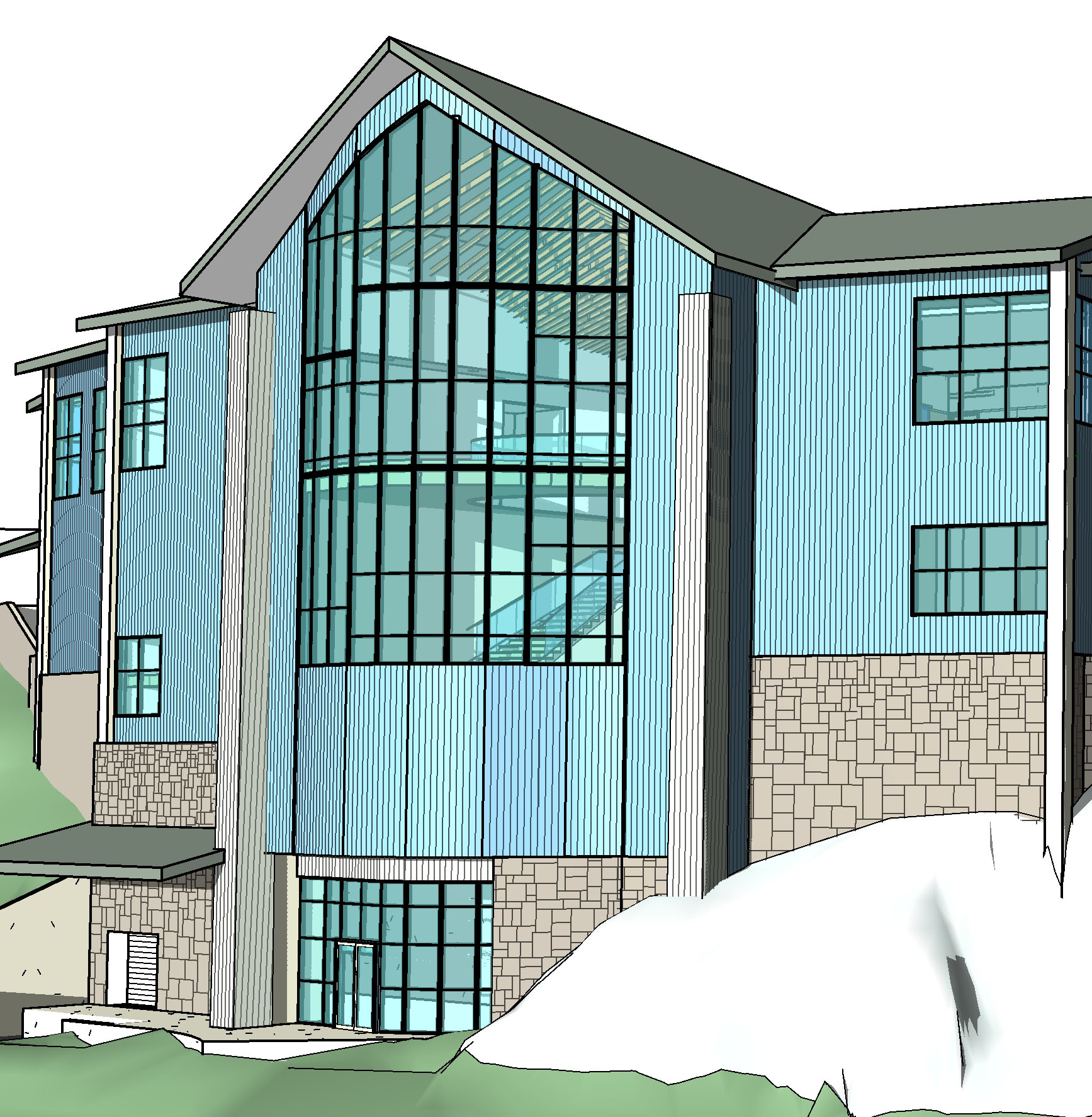

I second this.  You draw the hatch with drafting lines to the exact scale you wish -- within a boundary box -- select all the lines, and tell it to make a hatch.  I've used it for realistic wood grains that aren't excessively wavy, LARGE swaths of cobbled rock walls that graduate in size.
This is an 8' x 30' model hatch pattern. crazy, huh?
once upon a time super-efficient hatch patterns might have been necessary for CAD machines that used vacuum tubes instead of microcircuits... (okay, that's an exaggeration,) but on today's machines this isn't really a problem, considering the other burdens a 3D model places on the memory and processor.
pic related.
