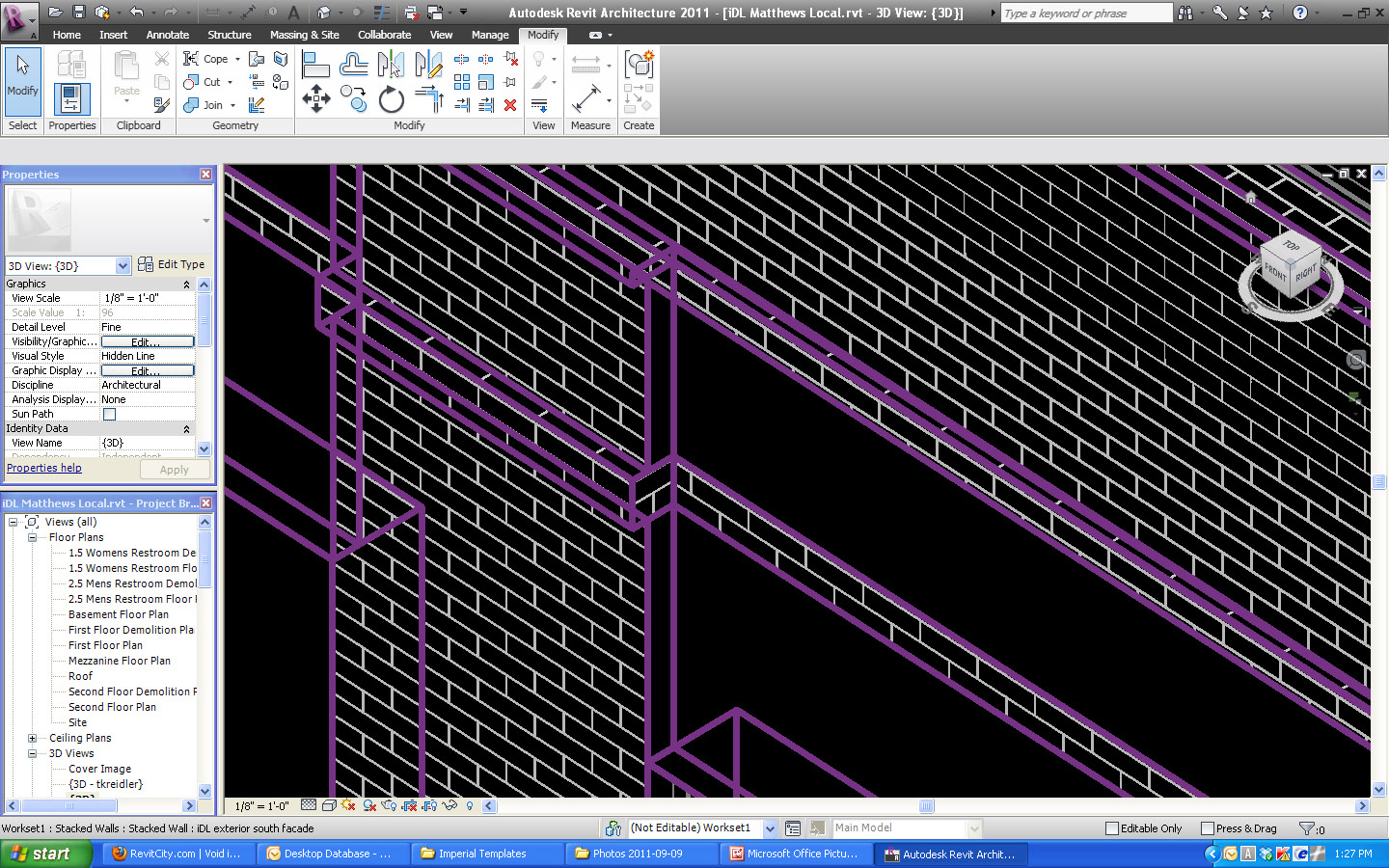

Hey all,
I finally got the void to cut the sweeps on my wall, but now I need to figure out how to have it visually look right.  can anyone help me with how I can add a brick pattern onto my void or recessed wall section?  curiously it works on the brick sweeps, but not the wall itself
revit arch 2011
thanks - joe

I would use the Paint tool to "paint" the material on the inside surfaces of the opening

that sounds pretty simple.  but where is the paint tool?
Fri, Sep 23, 2011 at 2:24:08 PM | pattern issue-void cutting through wall and sweeps
joe5676
Joined: Fri, Sep 23, 2011
15 Posts
nevermind,  I found it.
thanks!
