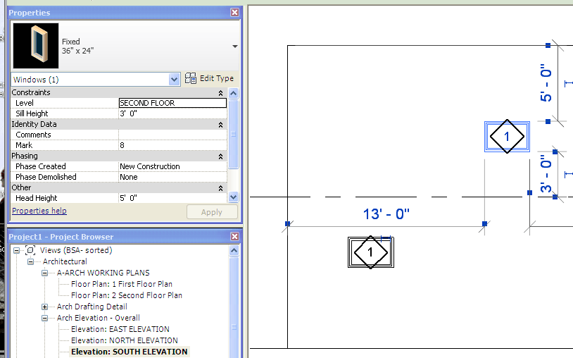

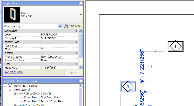

From your post, I assumed you were talking about elements other than windows.  When I placed my windows (see attached) from an elevation view, they automatically assumed the correct level, head and sill heights.
Must be your families.

no hub, they are assuming the level directly below, that level could be an intermediate level such as a mezzanine level. which would make the window incorrect for scheduling, which is the problem I have, they have picked up the level directly below, when infact I needed them to pick up the level below that Crying
