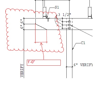

I would like to chamfer the end of a beams. The client does not want plumb cut beam tail. How can I get the result I need?

How about a face based family that cuts its host.

I have beem looking at how to do this.  I found that if you apply an Opening by face that you can make waht ever profile you want at the end of a beam.  I used this to make the profile of my trellis ends.  It might not be the best way but it worked quickly.
