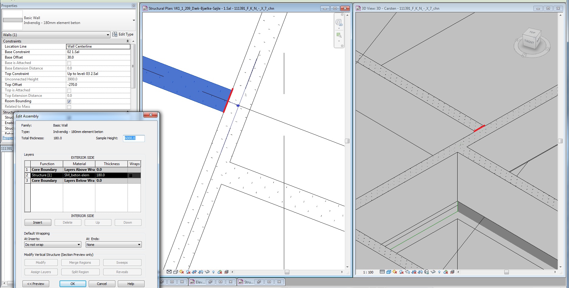

I have a problem with my concrete elements. I want the elements to stop by the red line and not to join the other concrete elements.
Can anybody tell me how I can do that?.
Hope you can help me :-)
Thanks
Carsten
Fri, Sep 16, 2011 at 7:00:46 AM | Stop walls that joins together
Pick the wall then right click on the blue dot at the end of the wall and pick "disallow join".
