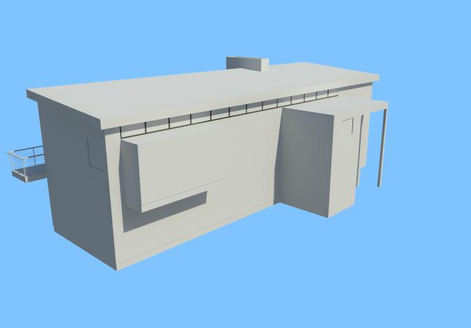

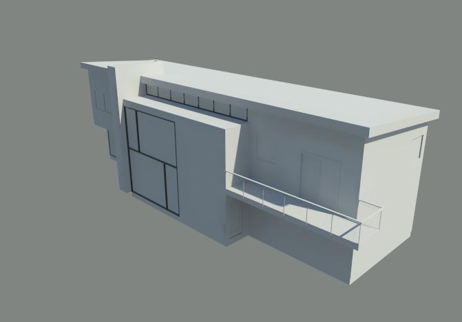

Please excuse my english, I need help, firstly I´m new to revit and to this forum. I have not found anything on this forum regarding this issue and if there is something please let me know.The problem is with a model I have been doing this week, thanks to a manual called "introducing revit 2010"(that is somewhat difficult to follow but anyways...), this model in 3d view, and in every view appears normal, with shading colors and materials, depending on the type I used ( curtain walls, windows, doors, exterior walls, masonery walls), BUT, when I go to render, the resulting image is white, just the sky have color, but everything else is plain white, the windows´glass isnt transparent and all families dont show their materials/colors. I have attached two different views so you know what I mean. Please I will be grateful if you help me with this, beacuse is very frustrating not knowing what is happening.
Another thing I should mention is that I unistalled and reistalled the program many times to see if this would fix the problem, but it sill remains.

Some possible solutions.
Change your username (profile corrupted related). You can find that on google.
Check if you have assigned textures/ or you have all the texture pack in autodesk library texture downloaded.( texture not found related)

I cannot fix this issue, I changedd the username, and nothing, When I go to options- Rendering and see that the path to the materials is ok, is this--- assetlibrary_base.fbx. The thing is when I first installed revit, I installed it with the imperial system, and the rendering was fine, the renders appeared as when you look at the model "shaded with edges" (with the colors and textures). BUT in my country we used Meters, so I decided to uninstall it and install it again in the metric system. After that I couldnt get a render right, so I need help maybe I need to do something else before installing it, but is very frustrating because there´s so little info for revit in the web regarding this problem, I think I am the only one in the world with this problem XD...PLEASE HELP ME!!!! I will remember you and pray every night for you!!!

do a CLEAN UNINSTALL and after that install in your own country units.
re-install revit with your own system.
You could just edit the templates... change unit inside them, and save.
