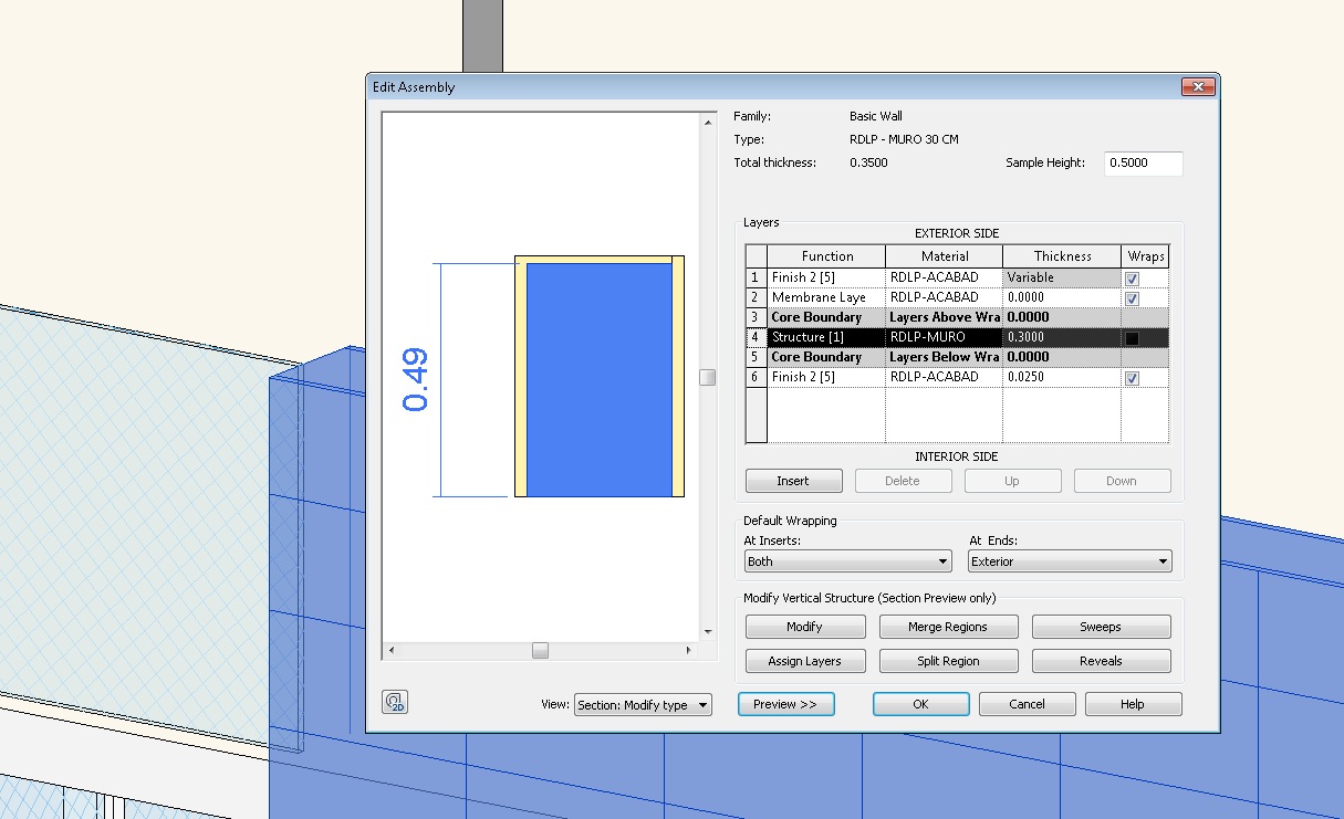

Hi, I'm trying to make a wall with a finish right on the top without using bad resources like a floor on top of the wall element, etc..
Is it possible to make a wall type that has a parametric feature that make the wall with the exterior/interior finish going somehow to the top?
Check the image I uploaded, I just did it, but revit wont let me to press OK without telling me it is wrong...
REGARDS!

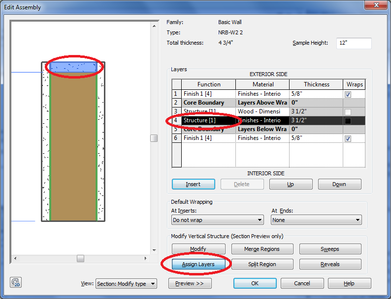

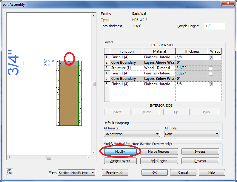

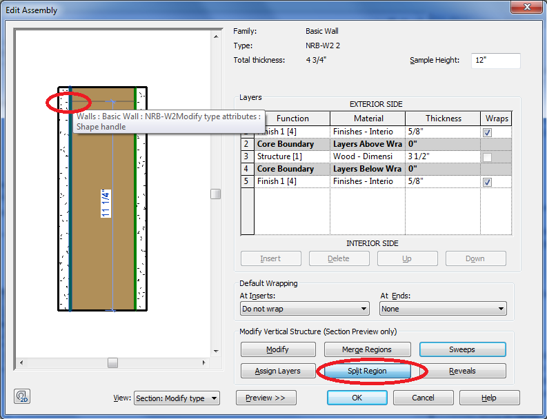

I agree, I don't think you can make the material wrap around the top. You could however force the materail there by splitting the core layer:
In your wall assembly:
Click on 'split region', and then click on your core layer in the preview window
Click on 'modify', and then click on the new split line in the preview window, a blue arrow will appear, click that to flip the dimension so it measures and locks from the top.
Click on 'insert' and add a layer below the core layer, don't give it a thickness
Click on 'assign layers', then click on the new layer you added, then click on the new region in the preview window.
Now assign a material to your new layer. It doesn't merge with the exterior layer but this may be the closest to what your after.

Thanks AbsoluteBIM, In this thread i posted an image where i was trying to make what you described with no success.
Now i just did exactly what you described on your reply #3, it just work fine for my sections and it is what i was looking for.
Hope adesk improves this type of details in the future to make it easier for an average revit user.
Thanks a lot!!
