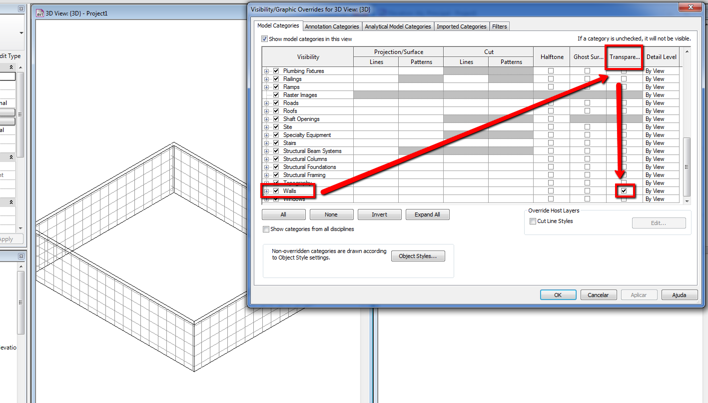

Hi all. Just new to this. I have students who have walls and components that go "transparent". No matter what I do I can't seem to fix the problem.

Did they change that in VG or "Override graphics in view"?

if it's a 3D view you might just have to re-create the view

If the problem is what Coreed said (to re-create the view) you can solve that with the web-updates for 2009, here you can download and install: http://usa.autodesk.com/adsk/servlet/ps/dl/index?siteID=123112&id=2334435&linkID=9273944#section4
