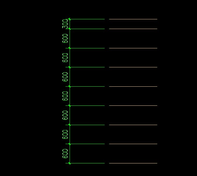

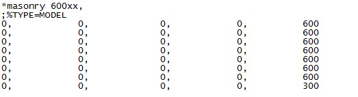

I want to make a specific pattern like my cad picture.  with seven six hundred millimeter and one three hundred millimeter horizontal line.  The second picture showed my pat file, but when I loaded it into my wall, it only shows three hundred millimeter pattern without the shift between 6 millimeter and 3 millimeter pattern.

Here you go. Its not perfect, but it works. Feel free to edit/share

I have worked out my script based on your pat, thank you!!!!
