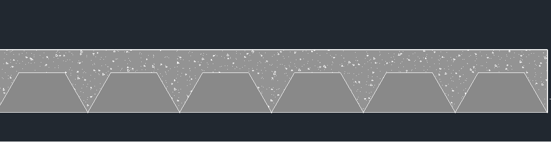

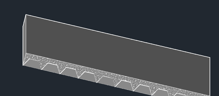

I want to build a deck element as shown in pictures below. I would not use "model in place" feature. Are there other ways you can model it in Revit?

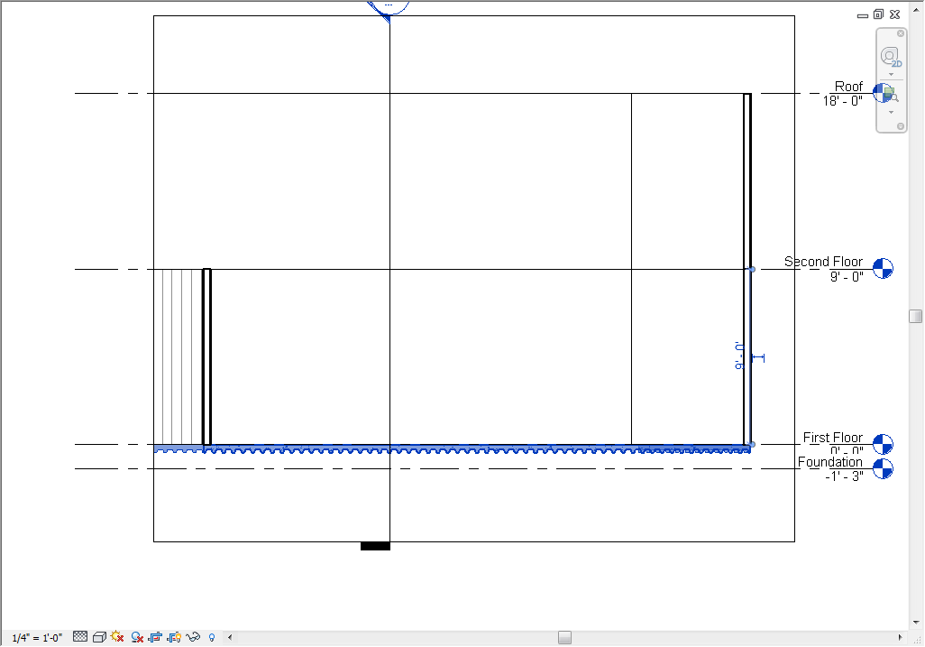

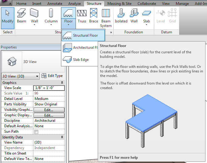

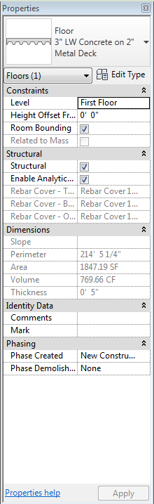

mbsteve is right, this is an out-of-the-box feature of revit, under the structural tab, create a structural floor (see image 1) if there is not a default floor set up, then create a new one with the properties shown in image 2. note that you'll have to load the deck profile in before creating the floor... Profiles\Structural\Form Deck_Composite

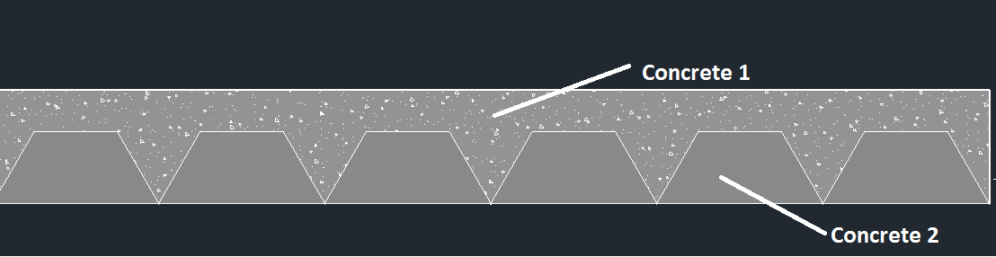

Thank you for your answer. It is not a standard deck, since we have two different kinds of concrete, which are merging. I had tried to solve the problem with"structure floor", but without success. Can you do it with "Structure floor 'or  another feature? Look at the picture below
