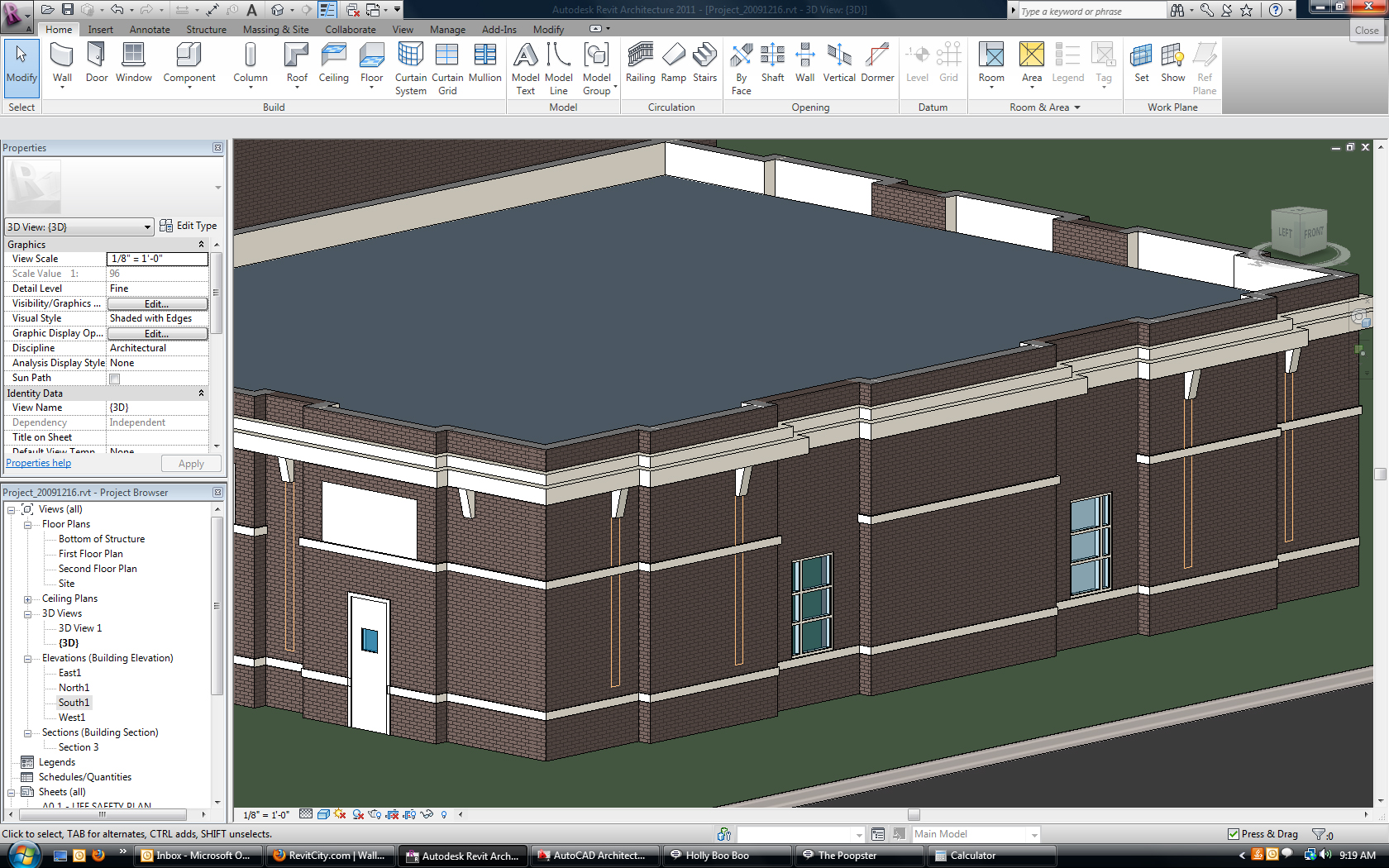

I created the Generic Wall Based model....created the void.  Placed it in my project.  It sits right where it needs to be on my wall, but it just gives me the highlighted orange lines showing where the void is.  No actual recess in the brick.  Help please?  Sad
Fri, Jul 9, 2010 at 9:04:53 AM | Wall Recesses
#10
You probably would have been better off by a faced based instead of wall based but you can fix this.  You have to make sure that you set the void to cut the wall in the family and you have to constrain it in such a way that it works with different wall thickness.  (You can flex the model in the family to see how different wall thicknesses work)
Face based models don't care what the thickness of the host is and are always on the face.  Your void may actually end up outside the wall or even behind the face of the wall.... In addition, you could then use this same family on almost any surface horizontal, vertical or at any angle.
Fri, Jul 9, 2010 at 9:49:00 AM | Wall Recesses
#11
mcordell6435
Joined: Tue, Mar 10, 2009
2 Posts
Thanks so much!  The face based generic model worked.  It doesn't work with all the choices I've made up to this point, but for anyone else, it would probably be perfect.  The face of the void stops at the outside face of the wall, which is also where my GFRC band begins.  Even though it doesn't actually intersect with the GFRC band in the middle of the wall (A sweep I added to the structure of the wall type) it breaks the line.  Not what I wanted.  Sad  (Image 1)  But I know could always remove the sweep from the wall type and just make the sweep a generic model component.
In case anyone else has the same issue, I chose an entirely different approach.  I created a separate wall type with the recess added in the structure of the wall.  So a 4'-8" segment of wall with the 8" recess is actually 2' of Wall Type 1 (no recess), 8" Wall Type 2 (with recess) and 2' of Wall Type 1 again.  (Image 2)  That way it also keeps my brick as my exterior material and I don't have to go paint each recess.
Hope this is helpful.
