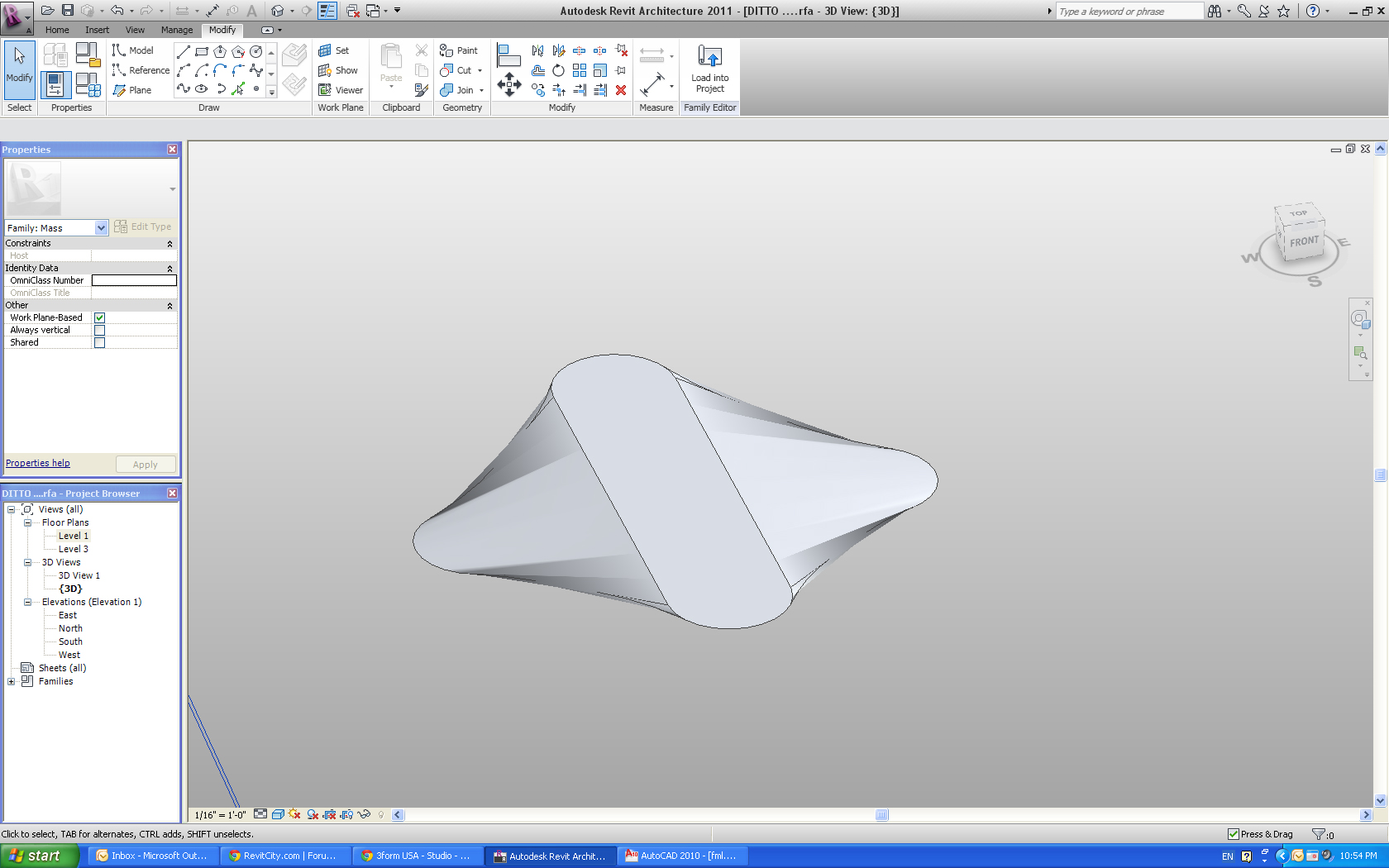

Hi, I am reletively new to revit and for the life of me cannot figure out how to make this object:
http://www.3-form.com/studio-ditto.php
http://www.3-form.com/studio-ditto-ditto_specs.php Cryingsee bottom of this pg for product specs)

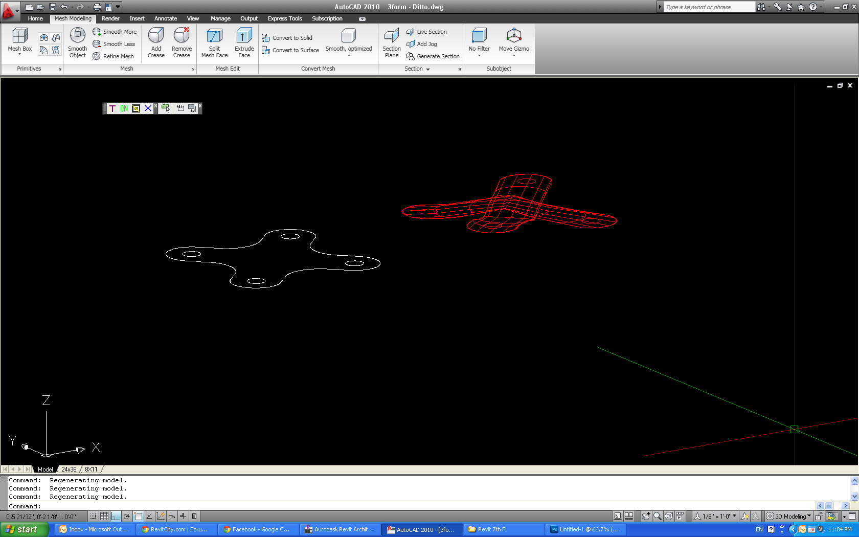

I have created the two forms and managed to blend them (as seen in the attached image) however each of the 'ovals' shud have a dip on the y axis.  For some reason I am only able to edit the forms on x plane... any ideas of what tool i can use or how i can create this shape?  Cryingsee image attached done in CAD)
I have literally spent 5+hrs on it and am no further along. Any help would be greatly appreciated.
Thanks!
Edited on: Tue, Aug 23, 2011 at 10:10:15 PM

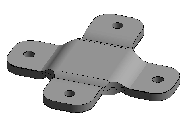

Wed, Aug 24, 2011 at 9:03:59 AM | plz help! blending curved forms in a mass
This is close but not quite there.  Done in the family editor.... think voids.
Wed, Aug 24, 2011 at 11:34:37 AM | plz help! blending curved forms in a mass
KMLNOW
Joined: Sun, Dec 12, 2010
2 Posts
WWHub that is perfect!  Do you think it would be possible to post that file?  You would be a complete life saver!
Wed, Aug 24, 2011 at 12:13:26 PM | plz help! blending curved forms in a mass
It wasn't wortt posting so I sent it by mail.  Use it as an example....
