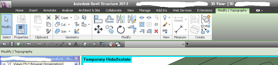

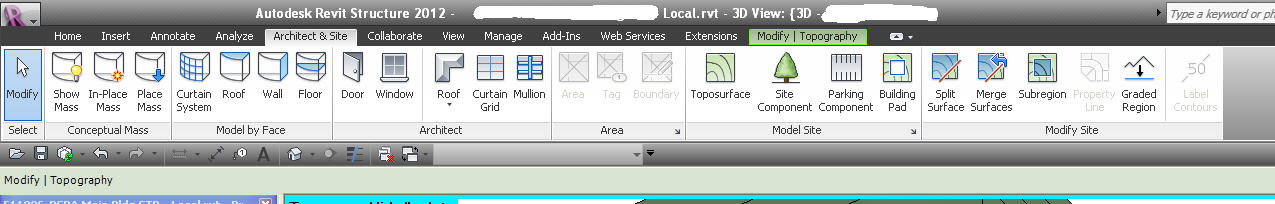

Here are screen caps of my architect/site ribbon and my modify ribbon, when I have the building pad selected, so you can see what tools are available to me.

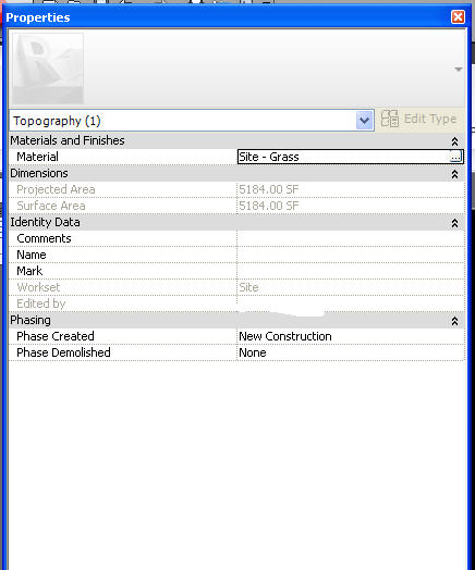

And here is the properties dialog attached.

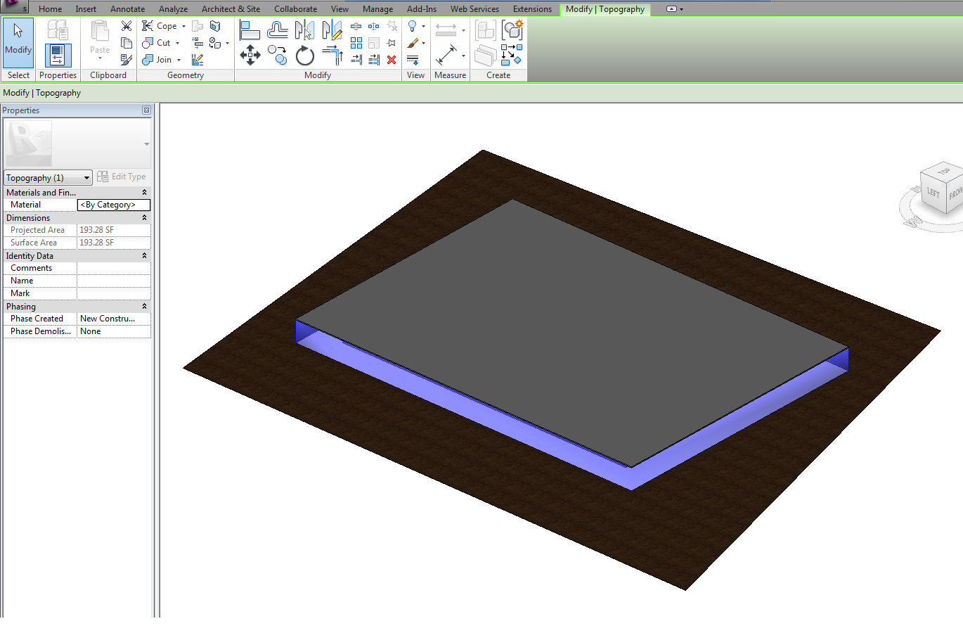

make sure your selecting the buliding pad and not the topography created by your builidng pad. I've attached two pictures, the first shows the topography selected and no options appear. The second picture shows the pad selected and 'edit boundry' appears on the ribbon.

I really think that your just not selecting the pad. the screen shot you included of the properties menu clearly shows that you are selecting the topography. It doesn't matter if its above or below the surface, i just did that for illustrative purposes. Try turning off topography in your visibility graphics, this should help isolating the pad.

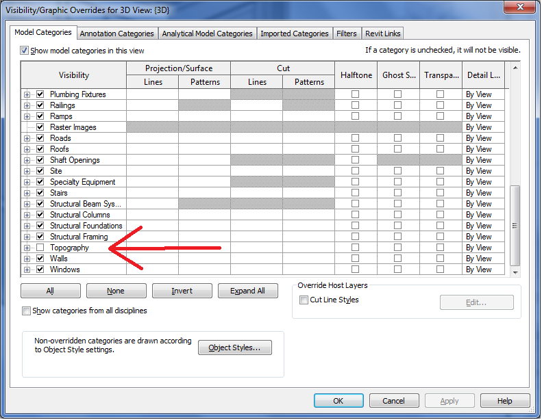

Wow, I am glad you pointed that out.  You were right, i had the pad turned off since I had the "site" category off, and only was showing the Topo category.  Guess I never realized that pads were site, not topo category.
